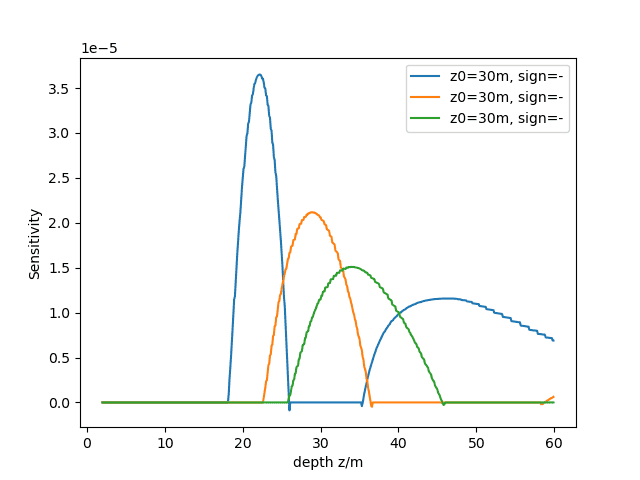

I have the following paper "Collecting Performance of a LiDAR Telescope at Short Distances":
http://earsel.org/wp-content/uploads/2016/11/3-3_03_Ohm.pdf
I am supposed to calculate the efficiency of the LiDAR, as shown in Fig. 4 in the paper. However, my graphs do not look at all as they do in the paper. I calculate b, B, M and P and with this AL as shown in the paper. Then I calculate Omega.
Then I integrate, as shown in Eq. (7). I integrate of the implicit variable r from 0 to R= beta *z / 2. The python code I wrote is shown below.
Reasons, I think I am doing something wrong:
• The Graphs look different
• There is a removable discontinuity when z = z0
• A lot of the graph is undefined, even when the graph is shown, parts of the makeup is undefined
Python:

Welcome to PF.
Can you upload your graphs for comparison? Use the "Attach files" link below the Edit window. Thank you.
