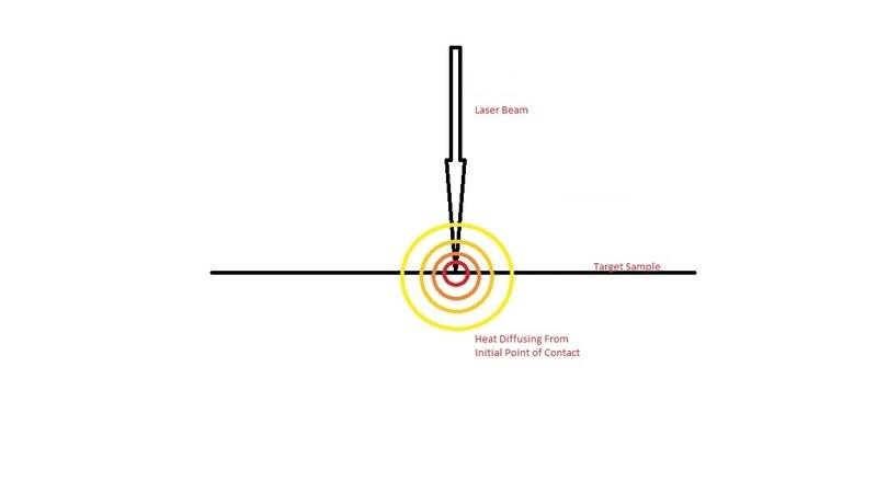

Hello, I am trying to simulate the heat diffusion from a laser beam striking a sample. My model/concept is very simple in that it assumes the temperature distribution will be a radially symetric sphere (i.e T=T(r,t)).
I would like to plot a temperature profile evolving through time as a function of position from the initial contact of the laser beam. I am not making a 2D/3D map of the temperature distribution but simply a position vs T plot evolve through time.
My question is that can I use the solution for the heat diffusion equation in 1D cartesian coordinates to simulate the temperature distribution from the initial point of contact or would I have to use the spherical heat diffusion equation. The reason is that the solution for 1d cartesian is readily available while in spherical coordinates obtaining the solution is a bit more difficult.
Heat Diffusion Equations
Cartesian
dT/dt=a(d^2/dx^2), where a represents thermal diffusivity
Spherical
1/r^2(d(r^2dT/dr)dr)=1/a(dT/dt), since no dependence on theta or phi
I am currently simulating the heat diffusion using the solution from the 1d cartesian coordinate heat diffusion equation but I am not sure if this is entirely correct. Also, I would imagine that my temperature profiles would be the same as long as a set my position axis to be centered at the origin (point of contact of laser beam).
