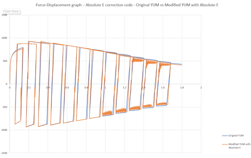

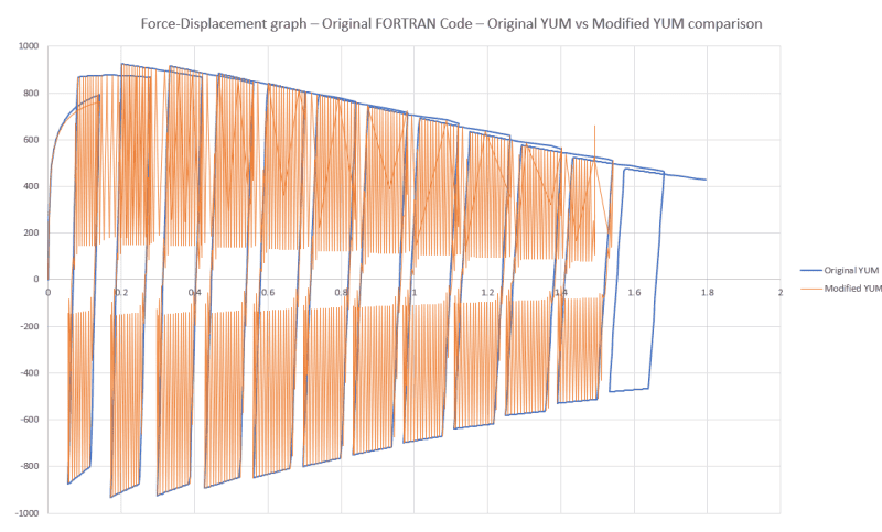

Further information:
To check the FORTRAN code, we used a RVE (a simple cube element). Original YUM formula mentioned in the research paper works correctly. The modified YUM formula gives negative E values at certain time points which can be seen as the oscillations on the Force-Displacement curve of Modified YUM formula. (Please refer Image1 below)
I modified the FORTRAN code to convert the negative E values to absolute values so it is always positive. This gave us almost the correct trend in the Force-Displacement curve. (Please refer Image2 below)
I wanted to test this code on the tensile test sample which is a notched tensile test specimen but it does not display the hysteresis as expected. Also, the simulation crashes so the image does not show the complete process (Please refer Image3 below)
I would appreciate any tips or suggestions as to how to simulate the hysteresis caused by cyclic loading on a tensile test specimen.

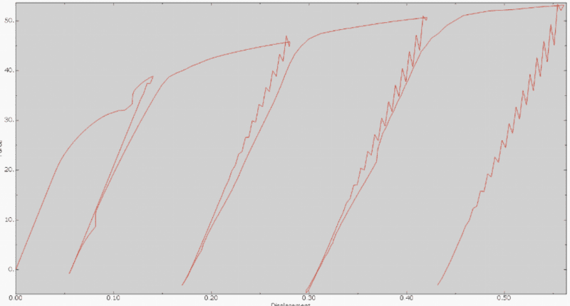

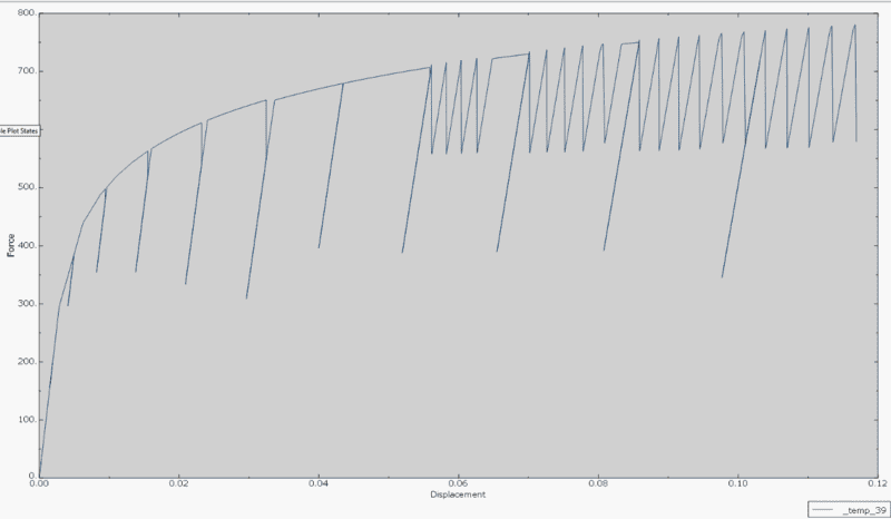

Thank you for the reply and all the information! You are right about the RVE, we used a single element model to test the FORTRAN code in the simulation and called it an RVE.
We are now focusing on the single element model to rectify the issue. The original YUM model is giving correct results as far as FORTRAN code is concerned but the issue seems to be in amplitude applied to the load. In case of single element model, the results are shown in Image1.
Here we can see the forces go further negative after unloading which seem to contribute to the plastification under unloading conditions. We found this to be incorrect as there is no compression action in a tensile test, rather just unloading. To correct it, we are tweaking the amplitude applied to the load and testing it. Following is the graph (original - incorrect) of amplitude applied on load (Image4):

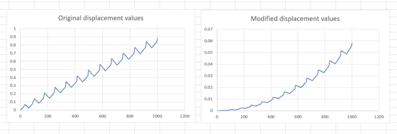

These points (original data) are the displacement values taken from the tensile test experiment. This data is reduced and fit to the original data to reduce the number of points using a code. Does it seem accurate to replicate the tensile test according to you? If you have any suggestions, please let me know. I am grateful for the help provided on this forum.
Thank you.
So that cyclic load is modeled as displacement boundary condition with amplitude ? Is incrementation and output frequency adjusted to the resolution of the amplitude ? Abaqus won't do it automatically, it could even solve the analysis in one increment if convergence allows, ignoring the amplitude resolution.
Likes MMTUser1
Yes, amplitude is applied to the displacement BC to recreate the cyclic loading. The time step is given as 0.001 and there are 1000 points in the amplitude data. That should be the resolution needed for the simulation, if I am correct.
The displacement values are directly taken from the tensile test experiment and made to fit the original data while maintaining the sample size = 1000.
Should we have used a Load BC and apply the amplitude derived from its data instead?
If you have any tips/suggestions, please let me know.
