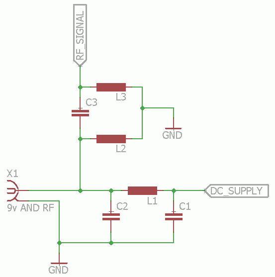

Hi,
as I am in need of Low- and Highpass filters i would like to simulate my circuit using LT-Spice.
I hope that i can get optimal caps and coils values like that.
So i simply started to build my pi-network lowpass filter in LT-Spice and got the simulation results (please check the picture in the attachement)
On my board i have a SMA connector, that ouputs the RF-Signals of an antenna mux and that same SMA connector is also used for the circuit board's supply voltage of 9V.
So now i need a Lowpass filter for the DC supply and a Highpass filter for the RF-Singnals.
I would like to simulate this in Spice, however I am not sure how to approach.
E.g. I am not sure what frequencies should pass for the DC supply and where to start blocking? (Lowpass)
For the RF-Signals, i need 860-870MHz to pass. (Highpass)
What are the typical values to start with?
(please check attachement for my filter structure and first approach to simulation, i started with a lowpass filter for the DC supply)
In Spice i made an AC analysis :
AC Amplitude: 10V
points per octave= 100, start frequency= 1Hz, end frequency=200MEG
Also I am think there's more about this simulation, i guess i also somehow should model the load etc.?
I would like to be able to estimate the values of my filters using simulation but I am way too new in this field so i hope you can help me.
I appreciate every little hint, explanations and links to further information! :)
Thank you in advance! :)Kind regards, Tom.

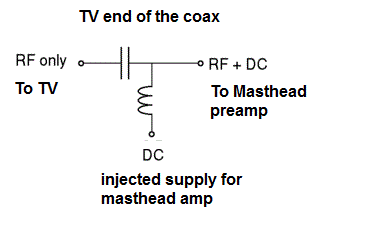

Hi there Tom
your description is a little lacking
can you draw a pic of what you are actually trying to set up please
I get a vague hint that you are trying to feed DC up a transmission line to feed power to another device ??
if so, a Bias Tee is the common way to go ... I just drew one of those for some one recently
here we go, found it ...
This was for someone who wanted to feed DC up the coax to a masthead amplifier, hence the TV and preamp connections
change that to what-ever you are using
for your 800 odd MHz something around 1 - 5pF cap ( those 47uF are for audio frequencies) and 3 turns of wire through a 6 hole ferrite bead for the inductor
also ...
depends on if you need the reverse at the amp (far) end or if for some amps(other devices) the DC voltage can be fed into the amplifying deviceSO, is that along the lines of what you are trying to do ?Dave

Hi Dave,
thank you so much for your reply, I am sorry for being that lacking ;)
I added an attachement.
DC_SUPPLY is going to supply all components on the board (adc-flash, rf-mux, priority encoder.)
So the higher frequencies should be filtered. (as in the pic, I am using a pi-network to do that)
I put 9V supply onto the SMA connector, to be filtered for the supply (the filtered dc supply is marked with "DC_SUPPLY" on the pic and from there on it will supply all other components").
But this SMA connector is also the output of the rf-mux ("RF_SIGNAL" marks where the rf-signals come from the mux output)
The RF_SIGNAL trace comes from a RF-Switch/Mux so i want to filter the DC frequencies out.
(before they leave the board throught the sma connector)
Im using the 860MHz-870MHz range.
This is the mux the rf-signals come from:
http://www.analog.com/media/en/technical-documentation/data-sheets/ADG904_904R.pdf
I would like to simulate these 2 filters so i can determine the optimal values for the coils and caps.
Im pretty new to this so please excuse my bad explanation and knowledge :)
Thanks a lot for your reply dave! :) Tom.
I think you are probably getting a bit over zealous with your filtering :wink:
now please confirm
DC is coming IN from the right and RF is coming IN from the top and they are combining and going OUT through the connector to the left ?
is that correct ?
if so, C3 will stop DC going out the RF IN port at the top ... absolutely no need for inductors L2 and L3 there, they serve no purpose
You only need an inductor on the DC IN port ( L1), it is your RFC ( RF Choke)
If C2 was resonant at your operating freq then it would be grounded, and that is a bad thing ... adding RF losses to the circuit
and having it resonant at any other frequency is pointless as it won't do anything
so again you end up going back to the bias-tee I showed you in my earlier post, by removing the not needed components in your circuit
cheers
Dave

Well, let me try again (sorry for the bad explanation ;)):
9V DC goes INTO the SMA connector and go from the SMA connector to the right (through the low pass filter consisting of L1, C1, C2 to the mark "DC_SUPPLY")
So from left to right.
The RF-Signals are coming from the top (the rf-mux) going down and to the SMA connector.
So from the top, going down.
Hope i made it clearer this time :)
Thank you! :)

Tom48 said:
but actually my filter should also work as it filters the DC out from the RF-path and the the HIghpass filters the RF out of the DC supply path?
you don't need the inductors in the RF path, they don't do anything to the DC. A single capacitor effectively stops DC, it's the way they work :smile:
and again, on the DC path you only need a coil ... if you really, really insist on using a cap there put it on the right side of L1, one of a few pF in value
there is NO Pi filters to be simulated
you are trying to make un-necessary work for yourself :biggrin:Dave

ok :D
Well, so how would i simulate your filter then? :)
I would like to accomplish a pretty accurate simulation of my filter setup (no matter what is its structure).
I would like to simulate it and play around a bit with the values to see what's the optimum.
Can u show me or give me a hint how to do that?
I would really appreciate it. :)
