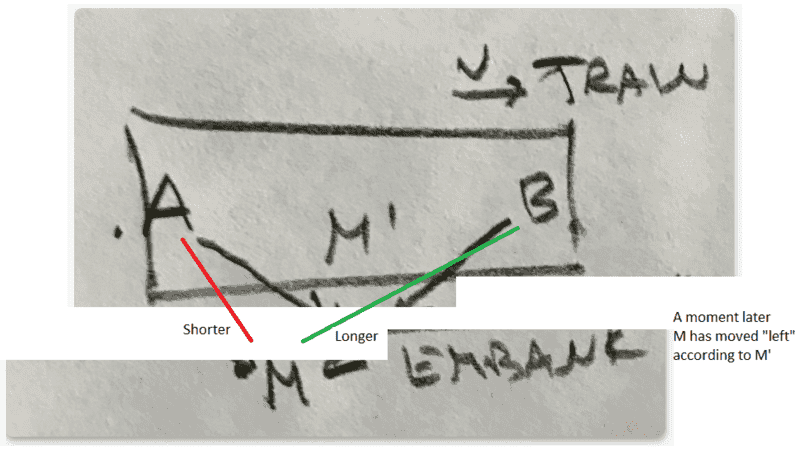

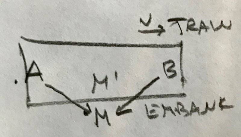

Imagine train car moving right at v. M' is midpoint of train car and M is the point on Embankment when M and M' are aligned, say at time T' for M' and at T for M. At T' (for M', A and B beams of light are triggered which are simultaneous for M'. Imagine A and B are affixed to the outside of the car. Why isn't it true that AM = BM in terms of distance at T and T'? I am assuming that the emissions of A and B are instantaneous and that, at that instant, the train hasn't moved forward, so the point of emissions of A and B are the same whether the train moves or doesn't. -- Not sure what I'm getting wrong here. -- Thanks.
There is no point in specifying time T and T'. Just set both M and M's to zero at the event where they pass one another.
With this simplification, both flashes are emitted at time 0 according to M'. They are simultaneous according to M'.
You seem to implicitly assume that "that instant" is a meaningful and universal specification. It is not.
According to M', "That instant" would include the set of events that all occur at time zero using clocks synchronized using the standards of M'.
According to M, "That instant" would include the set of events that all occur at time zero using clocks synchronized using the standards of M.
But the clocks of M and M' are systematically out of synch due to their relative velocities. Those two "that instant" sets only overlap at the midpoint where M and M' momentarily pass one another.
You've set up the problem so that "that instant" according to M' includes both flashes. But "that instant" according to M then includes neither.
From the point of view of M', it is M that is moving -v.
Also, light speed is finite, not infinite.
So the flashes from A and B can not reach M at the same time ... because M is moving towards A and away from B.
If the flashes are simultaneous for M' they are not simultaneous for M. So the distances AM and BM are equal - but the flashes did not happen at the same time so M does not see them at the same time.
You've set this up so the flashes are simultaneous for M'. Ok.
From the perspective of M' the flashes are simultaneous and equidistant from M', so M' receives them simultaneously. The flashes are equidistant from where M was when the flashes were emitted, but M is moving towards the rear lamp so sees that flash first.
From the perspective of M, the rear flash happened before the front flash. They were equidistant from M, so M saw the rear flash first. M' was moving forward at just the right speed that the light traveling forwards and the light traveling backwards happened to meet where M' was at the time.
Note that both descriptions agree on direct observations: M' received the flashes simultaneously and M saw the rear flash first. They only disagree on the interpretation of those observations.
If the two observers are side-by-side, then the lights will reach both observers simultaneously. They will agree on that. There is no disagreement regarding the simultaneity of events that are not separated in the direction of relative motion. However, the two observers will disagree on whether the lights started from the ends of the train simultaneously. They can not agree on the simultaneity of events that are separated in the direction of relative motion.

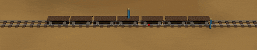

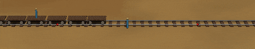

Consider this set pair of animations showing flashes arriving at both a train and embankment observer at the same time:
First according to the embankment observer:
He remains at a fixed point between the two sources, halfway between them for the entire time between emission and reception, thus seeing the flashes at the same time means that the flashes were emitted at the same time for him.
Now consider the same flashes of light according to the train observer:
He is, like the embankment observer, halfway between the sources of the flash when he detects them. However, this means he could not have been an equal distance from them when either flash was emitted, as at any moment before detecting the flashes he would be closer to the left source than he was to the right source. Since he must measure the speed at which the each flash travels as being c relative to himself, this means in order for the light of each flash to both reach him at the same moment he is halfway between them, the right flash has to leave its source before the left flash leaves its source, and the initial emissions of each flash cannot be simultaneous.
This particular animation doesn't take length contraction into account, ( something that would have to be accounted for if you wanted to extend the train so that parts of it passed the sources at the moments of emission) so it only demonstrates the principle behind the Relativity of Simultaneity and is not an exact representation.

I have another diagram for what may possibly be a distantly related thought. The image below was distorted in making a photo, but the idea should be clear.
It seems to me there are at least two ways of measuring simultaneity for a person on the platform and a person on the train. Start with the train observer: He could wait for the light to hit him at M' and make a judgment which would lead to him saying that A and B are not simultaneous (Einstein's point, I think). And the person on the bank at M can also judge in at least two ways. He can wait for the the light from A and B to hit him and then judge, in which case A and B will seem simultaneous.
Now whatever criteria Einstein used that he thought could establish for an observer on the train and one on the embankment that M and M' are at the same place at the same time, the same criteria could be used to establish that A and A' and B and B' are at the same place at the same time. So A', M', and B' align with A and M and B at the same time.
Now we might imagine 4 clocks all set at 0 and made to trigger when they are hit by a light coming from A and B and to mark that moment. So a second way for an observer at M to tell if A and B were simultaneous would be to walk over to A and B, after the fact and see if they were triggered at the same time. And the same for an observer on the train at M'. He could decide not to trust his eyes but to go and examine the two clocks and use them to establish simultaneity.
In this case it seems to me, both observers will pronounce that A and B were simultaneous, even if they will think the start and finish times of A and B are different.

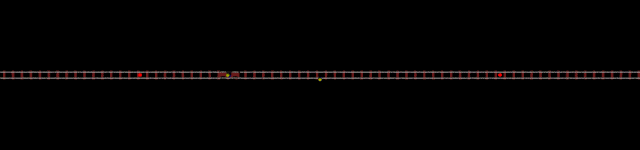

Here's the original train experiment as it occurs according to the embankment.
Flashes are emitted from the red dots as the ends of the train reaches them and the trian observer is next to the embankment observer. Train observer runs into right flash before left flash catches up to him. One thing to keep in mind is that since the train is in motion with respect to the embankment, the train is length contracted according to the embankment and this length contraction is what allows the train to fit exactly between the red dots.
However, according to anyone at rest with respect to the train, the train is not length contracted, but instead, it is the embankment that it in motion and length contracted. Thus the train cannot fit between the red dots, the front of the train hit the right red dot before the back of the train reaches the left red dot. Since both the train and embankment have to agree that the flashes are emitted when the ends of the trains pass the red dots, the flashes cannot be emitted at the same time according to the train, like this:
Note that according to the train, the flashes still meet a the the embankment observer. Also note that the midpoint of the train is next to the same point of the tracks when each the light flashes reaches him in both animations.
A and A' being next to each other is simultaneous with B and B' being next to each other in the embankment frame, but this is not true for the Train frame. when A and A' are next to each other B and B' are apart,and B and B' are together A nd A' are apart.
