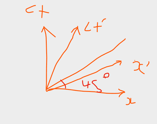

However, I don't know how to draw the spacetime diagram. I think we have to draw the events such that ##(\Delta x, c \Delta t) = (9,0)## and ##(\Delta x', c \Delta t') = (\sqrt{72}, 1 \times 10^{-8} c)##

Update: I made some silly algebraic mistakes in the last post. I have fixed them now and have go have solved (a), (b) and (c). However, I'm just stuck on finding the spacetime diagram now. I'm not sure where to plot the events.
My thinking is that we can plot the events anywhere as long as the spacetime interval is satisfied from (a). This is similar to trying to plot points on a Cartesian x and y plane given the Pythagorean distance.
