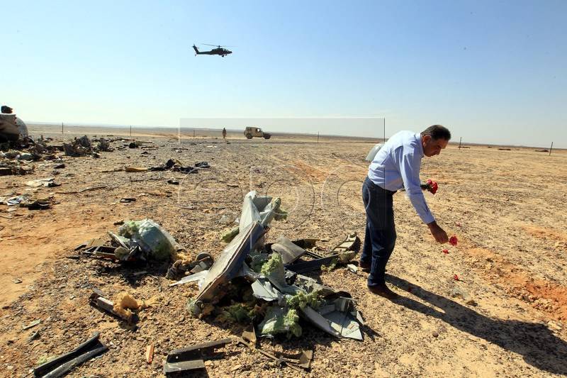

Investigators poring over wreckage of the Metrojet Airbus Group SE A321 in Egypt’s Sinai peninsula will be taking a close look at a 2001 repair to the plane’s tail because it is one of the few things known to cause the type of sudden midair breakup that occurred Saturday, said John Goglia, a former airline mechanic who served on the U.S. National Transportation Safety Board.
Part of the tail section on the Metrojet plane landed apart from other wreckage, indicating it broke off from the rest of the fuselage.
The plane’s tail had been properly repaired, Andrey Averyanov, deputy general director for engineering at Kogalymavia, which operates under the Metrojet brand, said at a briefing in Moscow Monday.
The plane, which was operated by another airline at the time, was repaired by Airbus in Toulouse, France, said Averyanov.
http://www.bloomberg.com/news/artic...suffered-prior-damage-linked-to-other-crashes

I'm curious to know how far the tail section is located from rest of the fuselage and wings. Some images show a charred area that looks like the wings and fuselage, whereas the tail section has no charring. Could a bomb have been located in the rear (either galley or cargo hold/bay) where is would have blown off the tail section?
Some kind of explosion seems to be implicated, but 'explosion' doesn't necessarily equate to 'bomb'.
If it was bomb the forensic evidence should be able to reveal that fairly quickly without even needing to open the data recorders.
There would be chemical residues and also damage to the airframe, cargos, and to passengers bodies which are typical of an explosive device.
Earliest reports of the crash site said that none of this bomb characteristic damage was seen.

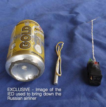

It was now confirmed that it was a terrorist attack. Sorry, no internet source, just saw it on TV.
