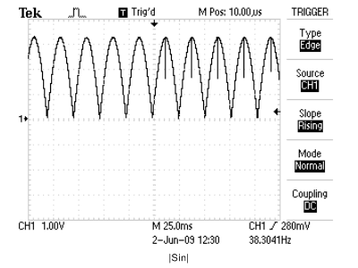

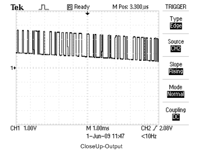

Hello everyone. I am working on a present for a girl (hehe) which will play a wav sound from an SD card into headphones. So, I have an SD card connected via SPI to a microcontroller which then connects via SPI to a DAC.
Right now I connected my DAC and now I am having problems outputting a sine wave. It comes out "fat". I am not sure if it's because I picked bad numbers or what. Please take a look at it and tell me if anything is wrong here. I am basically lost here.
I have a microproccesor MSP430F2012 (http://focus.ti.com/docs/prod/folders/print/msp430f2012.html").
Full code attached to this post. I am posting small snippets here.

Those figures are a reasonable shape for a quarter of a sinewave.
I graphed them with Excel.
But you need to then step down through the same numbers to go from 90 to 180 degrees and then go negative with the same numbers to go from 180 to 270 degrees and then step down through them again as negative numbers to go from 270 to 360 degrees.
Have you done that? Your display seems to indicate that you haven't done the 180 to 360 degree bit.
Probably you don't need anywhere near this precision, though, to get a sinewave.
Your "fat" waveform might be insufficient filtering. Looks like it.
As vk6kro said, your code is only computing one part of the sine wave. You'll need to fully compute the sine wave (with the trough corresponding to digital 0) and then feed that into the DAC. Then you'll need to remove the DC offset; a capacitor can take care of this. And finally, you'll need a good low pass filter for a variety of reasons: Smooth the waveform, possibly remove fatness, and to present a low output impedance to the headphones (since the cap will be high impedance compared to the headphones).

In order to graph negative I'd need a negative power supply. Which shouldn't be a problem, but I wanted to get it to be smooth and one line instead of a bunch of up/down waveform.
Why would I need filtering? Shouldn't the DAC be able to ouput a single point at each of the 16 bits?
Even if it's off at a couple then shouldn't it be more of a straight line with bad angles?
But why do I have fatness in the first part? I mean, I went this way to avoid using a low pass filter :(
This straight line with bad angles is precisely why we need filtering. From Fourier analysis we know that a "bad angle" is really comprised of infinite frequency components. The DAC's output will have these high frequency components in it and they must be filtered out; if not, it will show up in the headphones as a very noticeable hissing sound.
The output from that DAC appears to be pulse width modulation. So you need to filter the fast switching component to get the average level.
For programming convenience, you could calculate all values of your sinewave at 1 degree steps from 0 to 360 degrees and multiply by 65535 to get suitable values for your DAC. This will involve some repetition of numbers but make the programming a lot easier.
This would involve fewer numbers than you have now and 1 degree steps should still give an excellent sinewave.
How is a sinewave going to entertain your girl friend?

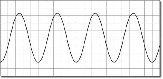

Not sure what the problem was, but that graph is not a sinewave.
See attachment.
To make it go faster, use fewer points and have the whole sinewave already in the program as data.
I tried 5 degree steps and it still looks like a good sinewave.
That only takes 72 data values.

As noted above, you do not yet have a sine wave; what you have is essentially a half rectified sine wave. You'll need to generate the "negative" part of the sine wave. And as I said earlier, this will create a sine wave with a DC component which you'll need to remove otherwise the headphones won't play anything. This "bumped up" sine wave is what you will have to deal with because your DAC only outputs positive voltages.
I thought that the speaker only requires the signal to be changing in order to hear a sound. Does it truly require negative voltages to be there as well?
I actually think I might have two or three modules which can do negative voltages. Do i need them?
The waveform you have will sound much rougher than a sinewave. A sinewave is a pure sounding note, but a bit boring and irritating after a while.
You don't need negative voltages. Just take your output through a suitable capacitor.
