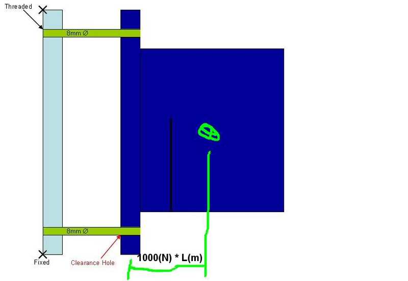

I've got a situation where I'll be placing a load (a vacuum pump) on two separate beams.
Basically, the pump attaches to a machine with a bolted flange. I'm wondering what would happen if we removed all the bolts except for the top and bottom one and let the pump hang...what the bending loads on the beams would be.
At first I was tempted to use the parallel axis theorem to find the resulting moment of inertia of the two beams. But then I thought that since the beams are independed of each other, and the load is free to slide on them then we simply must add the two beams' moments of inertia. However, that also doesn't seem 100% right as the beams are not 100% percent independent...they share a common load.
Does anybody know how to approach this problem?
