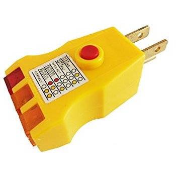

I have a question with regard to split single phase (in United States) electricity. I understand that there are 2 hot legs each 180 degrees out of phase at +120v and -120v (240v between hot legs) going from transformer to breaker box and a center tapped neutral Earth bonded wire at 0v with respect to ground. So if a light bulb is my load on 120v circuit (hot leg and neutral), aren't both the "hot" and "neutral" carrying carrying the whole time in opposite directions? The bulb doesn't care which is which because the polarity changes 60 times per second right?

That isn't quite correct. They carry the whole time in reversing directions. Think of a loop going from generator, to load back to generator. The current goes clockwise then counterclockwise around the loop.
For safety and shock purposes, consider the hot and neutral wires the same.
There is also the related topic of grounding, but that leads to even more millions of answers.
There is also a third ground wire that plays no role in "normal" circumstances but you have no intuitive way to know if your wiring is in normal or abnormal condition, so the safe thing is to presume all three wires are dangerous and not spend much time imagining circumstances where they might be not dangerous.

You should treat neutral wires the same as live wires. You never know if someone made a mistake with the wiring.

The neutral is generally less dangerous because if operating properly it has no voltage with respect to ground, by definition. With no voltage, it can't drive a current through you.

No, not by definition, by convention. Do you really want kids guessing which one is neutral and trying it out?

Except for when Line and Neutral are reversed (I've seen this too many times in DIY wiring and other situations), and I've also gotten mild shocks from Neutral-Ground when I'm sweating and working on an electrical box far from the breaker panel (so there is a small voltage generated by the Neutral return current.
Not to mention when a person gets confused as to which conductor is Neutral and Line. In general it's a bad practice to touch either Neutral or Line, IMO. I'm with anorlunda on this one.

I'm going to close this thread at this point, since it has turned into a discussion of what can shock you and what is not likely to. Amateurs and newbies can just make too many mistakes. Heck, I've made a few myself over the years, and am lucky to still be here.
