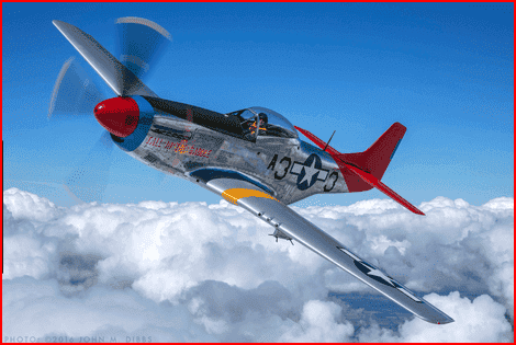

Can you say more about your question and give some examples please? What type of aircraft? (Cessna or P-51 or ?) What types of turns? What speeds?
https://www.google.com/search?tbm=i...-wiz-img...0.8doC15a6kdI#imgrc=rhjkxwk9k4PRYM:
242817
I am basically talking about low wing WWII fighters in sustained speed 3.2 G level turns, which implies maximum prop load (around 3000 lbs full power, full low speed sustained level turning load on about 100 square feet I'm told, or roughly 30 pounds of thrust per square feet).
Turning implies slower air on the inside turn half (or more) of the prop disc, which implies a greater blade front vacuum on the inner turn disc side. This implies more inside turn disc half thrust, which in turn implies a slanting of the thrust axis towards the outside of the turn, in addition to off-centering the thrust center towards the inside turn side.
This curving air cannot be replicated by slanting the air in a wind tunnel, since that does not replicate the slower inside turn air. Given the leverage of a 100 square foot plus disc surface, the effect must be significant compared to a four square foot jet plume... I figure 1 pound per square foot per degree (for typical 7 degrees max sustained) would easily yield 700 pounds of continuous extra asymmetrical thrust, slanting the thrust axis towards the outside of the turn.
This has nothing to do with low-speed torque, yaw, or the higher speed slip stream spiral. It is strictly the issue of making a broad flat surface follow a curve... Contrary to those other effects, I have never found anything concerning the airflow speed asymmetry... The effect is obviously there for many reasons, including WWII prop pilots lowering throttles long before the merge, and lowering power even further after being in continuous slow speed turns on the deck. When a turning contest became prolonged and on the deck, the contest often seemed to be who could lower the power the most to gain the faster sustained turn rate (in multiple consecutive 360s)...
WoA

Sorry, but I'm just not seeing how the issue you are describing is functionally different from P-factor, and also would like to point out that a 3.2 g turn is 70 degrees angle of bank, so the plane is pitching into the turn more than it is yawing. Some analysis:
Google tells me the P-51 has an 11' diameter propeller and a minimum turn radius of 531' at 270mph and an 18.5 degree stall aoa. So the difference between inside and outside of the turn for the propeller tip is 2% of the turn radius. At 270mph, that's 5.4mph.
I think the minimum radius turn happens just below stall aoa. An 18 degree aoa yields a differential of 31% or 83mph. Note, that this is exactly aligned with the pitch axis and the thrust differential aligned with the yaw axis (not the turn axis).
So that's why I don't think this is something much talked about. Note that the speed differential between the inside and outside wings is of course many times larger and therefore is considered/discussed much.
That's said, I think I do get the difference you are referring to: the P-factor causes a pitching plane to yaw, so it or a similar effect would cause a yawing plane to pitch.

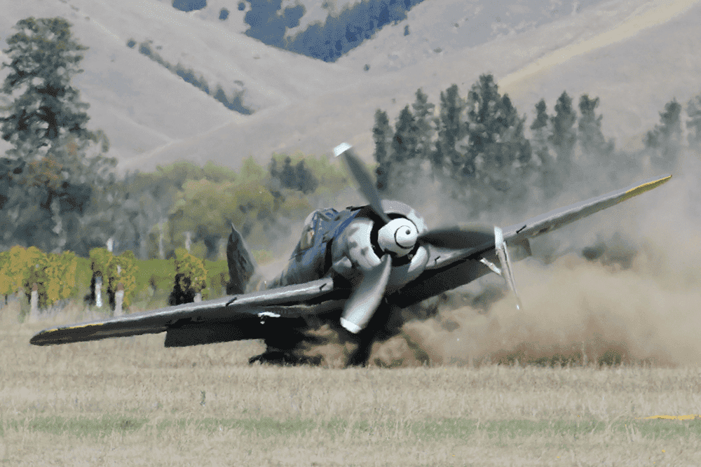

They're messing about with precession. I don't suppose you've a video link ? That sounds interesting (and hilarious) to watch.
(assumption: "on the deck" meaning "on the ground/ship's deck", not "at a very low altitude")
I'm pretty sure WrathofAtlantis is talking about low altitude sustained turns, not just spinning around on the ground (though that does create a hilarious mental image)
cjl said:
I'm pretty sure WrathofAtlantis is talking about low altitude sustained turns. . .
I'll go along with that. . . . :ok:
cjl said:
. . .spinning around on the ground (though that does create a hilarious mental image)
Pilots usually don't see it that way, maybe, a distressing mental image ? . :oldwink:
243273
Ground loop. . .
