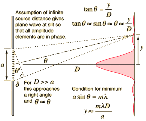

I'm wondering something about illustrations of single slit interference. I've seen them being illustrated in different ways. One way is this:

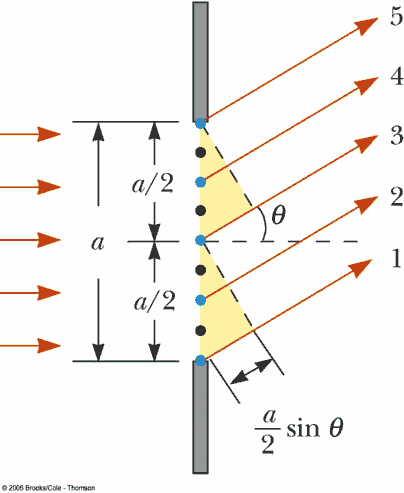

and another way is this:
But I don't understand how these can show the same thing? In the first picture, we have light rays that are obviously NOT parallel, because they all point to a single point. But in the second picture, there are several rays that are all shown as parallel. How is that possible? The rays can't be both parallel and not parallel at the same time!

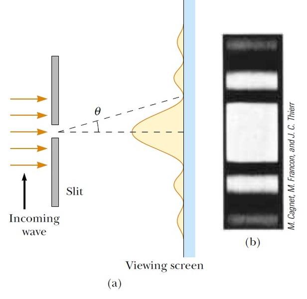

And another question. In the second picture, it is shown that light is coming in horizontally from the left. Why is it then suddenly tilted with angle θ? Why doesn't it just continue horizontally into the slit? This following picture makes much more sense to me:
Because here at least we see that the light will continue horizontally and the angle θ is simply to show where destructive interference will take place. But this is again different from the two other pictures. Can someone please explain how all these pictures are related and how they are meant to show the same thing?
I mean none of the first two pictures make sense if we consider that the light will diffract like a point (omnidirectional) source at each point which it does according to Huygens principle, only the third picture shows that.

The first picture illustrates a general setup, the second is an approximation by taking the first pic and letting D>>y. This means that the actual angles for each numbered ray are very nearly the same.
This is actually written on the 1st diagram.
This is the wave nature of light - have a look at water-waves traveling through a narrow opening ... the observation is that light appears to behave the same way.
Note: the angle shown is only one sample light-ray.
it's the other way around. We need to use several point sources at the slit, to be able to calculate the interference pattern. If we just used one point source at the slit, then there is no interference pattern.
It's puzzling that you would complain about the abrupt change in the direction of propagation of light but go on to mention Huygens principle which is the explanation for how the ray can in fact change directions. Out of the three pictures, the one you liked the most - the 3rd one - is really the only one that isn't very good since it doesn't show that neighbor rays may have different path lengths allowing for destructive interference to happen explaining the dark bands of the interference pattern.

Our best understanding is that the Laws of Classical Physics are approximations in the limits of 'large' sizes and numbers and that quantum mechanics is the correct description of the world. (of course, when we talk about even larger or faster things we need to consider Relativity). It can be a serious mistake to invoke a 'principle' from 1680 (or 1820) to 'explain' the world. Please take a look at this article:https://en.wikipedia.org/wiki/Huygens–Fresnel_principle. None of the diagrams you posted are correct, ALL 3 are great simplifications. The concept of light RAYS should only be used for every-day optical scenaroies, not for the very small (such as a slit experiment).
