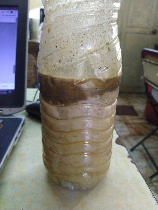

Hello guys, I'm back after kind of a hiatus. Hope you'll are doing well :oldsmile:
So i have tried a pre-pre-preliminary trial with a sample of wastewater i had collected during a visit to a client. The wastewater was basically effluent from an Ultrasonic Part Washer. Effluent consisted of an alkaline cleaner in 3-5% concentration with water used for over 2 weeks. There is a thick layer of oil and the liquid has quite a fair bit of suspended particles from the washer.
Here's a pic of the effluent - https://ibb.co/K02SCGW
So i have treated 100ml samples of this liquid at a time with 0.5-2% of the Cleartreat flocculant (link posted in one of the previous posts). Four different Flocculants were tried with varying degree of results. For agitation, I stirred using a spoon :oldbiggrin:
I observed that most Flocculant powders worked upto a certain extent at the first dosage of 0.5%, in that they helped form Flocs that floated on the surface of the liquid (https://ibb.co/zQf9NMB) but could not clarify the water as it remained turbid. Further additions upto 2% did not really help.
The size of Flocs formed were different for each Cleartreat sample.
I then went ahead and filtered a particular treated liquid sample and what I observed was that most suspended impurity was filtered out, but the filtered liquid was yellow in color. Pic - https://ibb.co/99rdLz9
The pH of the effluent checked before treatment was approx. 9.5. I did not do any pH adjustment nor did I check the pH of the sample post treatment.
Views and opinions please?

You filtered after flocculation. How long did it take for the ~100 mL?
I would try heating to nearly boiling after treating with flocculant. Fine oil-in-water dispersions sometimes coalesce when the emulsifying agents are heated with gentle to no stirring. Heat after floc treatment.
Don’t know what could be yellow. These parts have cutting oils on them? Could be an additive or base soluble dye used in greases or lubricants. Take out a portion and acidify with strong acid like sulfuric until just acidic (pH=2-3). See if anything separates after acid treatment.

Filtration of 100ml took about 10-12 seconds. I used a cutout of the paper bed filter from my CNC for this. A lot of the flocculated gunk would settle on the paper, but the liquid did filter through slowly.
Yes parts have cutting oils on them for sure. I was thinking of bringing the pH down by adding sulfuric acid before treatment. Would that help? Shouldn't the oil coalesce due to the clays present in the flocculant?
Will adding sulfuric acid to the effluent not disturb any other properties of the liquid?
I could try boiling, but if that even works out, it would be difficult to implement on a larger scale owing to large electrical loads and the necessity of cooling the liquid post treatment.
1. Would acidifying before flocculation help? I don’t know but perhaps. There are emulsifiers likely present to suspend the oils. If they are anionics, acidifying will cause them to become insoluble in water and they will cease being emulsifiers. If they are non-ionics, little would change.
2. Wouldn’t the clays in the flocculant cause the oils to coalesce?
Mostly, yes but the smallest droplets have much to overcome to reach each other or a clay particle. At high pH the clay particle is negatively charged and could be repelled by the small oil droplets covered by an emulsifier with its (potentially) negatively-charged end groups pointing outward into the aqueous environment. Like charges repel. Any information from the floc mfgr about optimum pH for use?
3. Would adding sulfuric acid disturb any other property of the fluid? It will likely disturb every property of the fluid. Can you live with that?
Adding acid was only suggested after floc treatment to diagnose the yellow color, actually. If a yellow oil separates upon acidification, you can remove it and identify it to decide how to proceed. Adjusting pH before floc treatment might be something to try if you can live with the new pH. If you adjust pH, perform a more efficient cleanup/flocculation and then return the pH to alkaline, you would need to live with the higher salinity (sulfate salts) in use. That’s why I wouldn’t use HCl to adjust pH. Cl- attacks ferrous and aluminum alloys under sonicating conditions.
