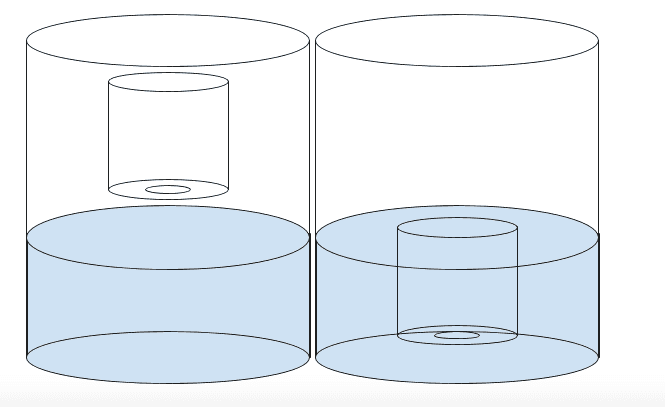

This isn't the greatest drawing but here it is:
243867
I'm measuring the time taken for the cylinder to completely submerge from the surface level.
The situation you need to analyse is steady state descent, so half submerged, say. Show the internal and external water levels.
No need for perspective; a side view will do.

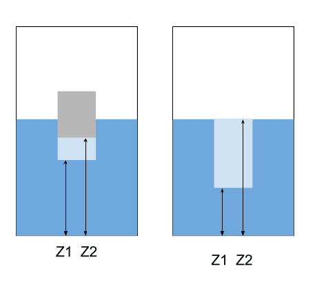

I know that:
##\frac{1}{2}\rho u^{2}+pgz_{1}+P_{1}=\frac{1}{2}\rho v^{2}+pgz_{2}+P_{2}##, where
##ρ## is fluid density, ##u## is the rate of in-flow, ##v## is the rate of descent of the cylinder, ##z_{1}## is the height of the bottom of the cylinder from ground level, ##z_{2}## is the height of the surface of the liquid within the cylinder from ground level, ##P_{1}## is pressure at the small hole and ##P_{2}## is pressure surface of the water inside the cylinder.
Also:
##A_{1}u=A_{2}v## where
##A_{1}## is the size of the small hole ##\pi R^2## and ##A_{2}## the cross-sectional area of the cylinder ##\pi r^2##.
So I can write the first equation:
##\frac{1}{2}\rho u^{2}+pgz_{1}+P_{1}=\frac{1}{2}\rho (\frac{A_{2}u}{A_{1}})^{2}+pgz_{2}+P_{2}##At time TT where the cylinder is completely submerged it will look like this:

This is very hard decipher. Please repost with the LaTeX working properly.

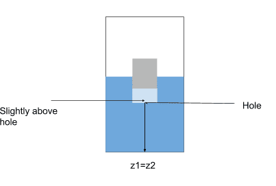

ρgz1
The z terms in Bernoulli refer to heights from some common level. The water just below the hole is effectively at the same height as the water just above it. The pressure difference vertically across the hole is accounted for by the P1 and P2 terms.
P2P2 is pressure surface of the water inside the cylinder.
P2 should be the pressure just above the hole, not at the surface of the water.

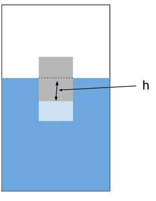

A couple more thoughts...
Since we are assuming steady state, z1-z2 will be constant.
The depth to the bottom of the tank is irrelevant, so instead create a variable for the depth of the bottom of the cylinder. What is the relationship between that and v?

Is this between the surface of the water inside the cylinder and the bottom of the cylinder?
I just realized...isn't the Bernoulli equation for the speed of the water, and not of the cylinder? If I were to take two points, inside and just above the hole at the bottom, all I'm doing is finding the speed of the water, and not of the velocity of the descending cylinder itself. I still don't see how the Bernoulli equation can account for this? This is why I had the ##F_{net}## equation in the first place...to find the downwards force and then find the velocity from that (I think).
243880
It can be depth below the outside surface or depth of water within the cylinder. Create another variable for the difference between them.

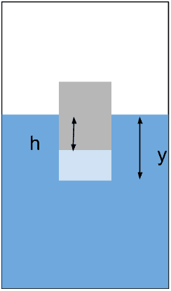

So the diagram would look something like this; I am to find the relation between ##v##, the rate of water just above the hole and ##h##.
243891
Well since ##h## diminishes to 0, and speed=dist/time, I can write it as ##v=\frac{h}{T}##? I would then use the Bernoulli equation above and place ##v=\frac{h}{T}##? and ##u=\frac{V}{A_{1}T}##?
Sorry I know you're helping but I'm terribly thick in the skull sometimes.
since h diminishes to 0,
Why would it do that?
As I wrote, try assuming steady state, i.e. the cylinder descends at a constant rate. What does that say about the relationship between the buoyancy force and the weight of the (empty) cylinder?
In terms of your diagram in post #14, what is the force of buoyancy?
Since ##F_{buoyancy}## is proportional to the volume of water displaced...in this case, it would be the cross-sectional area of the cylinder multiplied by the height of the water within the cylinder (H), so ##\pi r^2 H##.
##F_{weight} = F_{buoyancy} + F_{drag}##
##(m_{water}+m_{cylinder})g = \rho g\pi r^2H - bv^2##?
Does this mean the weight equals the sum of drag and buoyancy?
Yes, but let's see if we can get a result ignoring drag for now.
Did you mean that? What is this H? Is it different from h in the diagram?
Yes sorry I think I misunderstood; I was calculating the volume of water inside of the cylinder, and H is just the height of the water inside the cylinder from the base of the cylinder.
I need buoyancy so instead, I would calculate the volume of water displaced; in the case of my diagram in #14, the volume of water displaced is the volume of the cylinder itself under the water surface?
Right, assuming you mean the surface outside the cylinder, but there is also water in the cylinder, so that much is not really being displaced. The displaced volume is the airspace.
So this value of volume being displaced is ##\pi r^2h##, ##h## being from the diagram from #14?
Yes. Can you answer my other questions in post #15?
##F_{buoyancy} = F_{gravity}##
##F_{buoyancy} = \rho g (\pi r^2h)##
haruspex said:
What do you conclude about h?
##h=\frac{m}{\rho \pi r^2}##
So ##h## is proportional to the inverse square of the radius of the cylinder?
Yes, but the important point for now is that h is constant.
It's going to make the algebra a little easier if we just write A for the cross-sectional area of the cylinder and a for that of the hole (instead of having to write ##\pi r^2## everywhere).
Next, say the depth of the bottom of the cylinder at some instant is y (below the outside water level) and the velocity of water entering the hole, relative to the hole, is v.
What differential equation relates A, a, v and y?
243949
Since the rate at which the water rises is ##v## so ##\int vdt=y-h##? I know ##h=\frac{m}{\rho A}## so ##\int vdt=y-\frac{m}{\rho A}##?
No, I defined v as the linear speed of the water, relative to the hole, as it flows through the hole. In time dt, what volume is that?
##dV=vA\frac{1}{dt}## where A is the area cross-sectional area of the hole?
Almost, but 1/dt?? That doesn't mean anything. Also, I specified a as the cross section of the hole and used A for that of the cylinder. Please stick to that.
Since ##Q=\frac{dV}{dt}##, and ##Q=va##, so ##dV=vadt##?
Right.
So what is the increase in the depth of water (y-h) in the cylinder in dt?
haruspex said:
Right.
##d(A(y-h))=vadt##
##dt=\frac{d(A(y-h))}{va}##?
  • #31
##d(A(y-h))=vadt##
Right.
But A and h are constants, so can you rewrite that in the form dy/dt=...?
  • #32
The next step is the Bernoulli equation. Need to be careful, though. The v I defined is relative to the cylinder, and the cylinder is moving. Bernoulli will tell you the gained velocity in the lab frame.
  • #33
haruspex said:
Right.
##\frac{dy}{dt}=\frac{va}{A-h}##?
So if ##u## is the negative, downwards velocity of the cylinder [at the hole = above the hole]
##\frac{1}{2}\rho (v+u)^2+\rho gz_{1}+P_{1}=\frac{1}{2}\rho (\frac{a(v+u)}{A})^2+\rho gz_{2}+P_{2}##?
  • #34
No, you've made some mistake in the algebra. Try again. A-h makes no sense, you cannot subtract a distance from an area.
Not sure which is 1 and which is 2, but the water is stationary below the hole.
As already noted, z1=z2, so you can cancel those.
What expressions do you have for P1 and P2?
  • #35
##\frac{d(Ay)−d(Ah)}{dt}=va ##
##\frac{Ad(y)−Ah}{dt}=va ##
##\frac{d(y)−h}{dt}=\frac{va}{A} ##
##\frac{d(y)}{dt}=\frac{va}{A}+h##
Is this correct?
I see.
Below the hole = Above the hole
##\frac{1}{2}\rho (0) + \rho gz_{1}+P_{1}=\frac{1}{2}\rho (v+u) + \rho gz_{2}+P_{2}##
Since ##z_{1}=z_{2}##
##P_{1}=\frac{1}{2}\rho (v+u) +P_{2}##
I rewrite pressure in terms of the depth from the surface of water?
##P_{1} = \rho gy## and ##P_{2} = \rho gh## so
##\rho gy=\frac{1}{2}\rho (v+u)+\rho gh##
##gy=\frac{1}{2} (v+u)+ gh##
