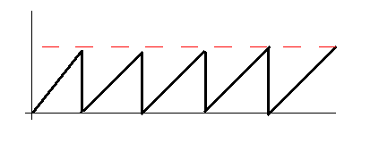

An exemple of a periodic function that can be approximate by Fourier series is:

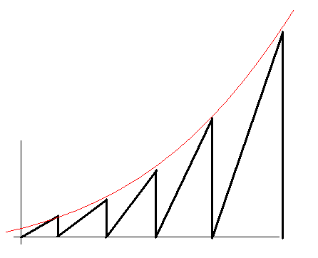

And another exemple of a "periodic function with exponential variation" is a function like this:
So, if exist a exponential factor in the Fourier series, this serie would be perfect for represent this second graph. Yeah!?
The function in the graph is not periodic. For a periodic function whose period is p, f(x) = f(x + p), for any x.
True! But, what say about a Fourier serie with factor exponential?
The Fourier series for a function is periodic, but if you multiply that series by an exponential function, the product is no longer periodic. I'm not sure I understand what you're asking, though.
The Fourier series, roughly speaking, is ##f(t) = \sum_{-\infty }^{+\infty } A_\omega \cos(\omega t - \varphi_\omega ) \Delta \omega ##, I was thinking in a serie like this: ##f(t) = \sum_{-\infty }^{+\infty } \sum_{-\infty }^{+\infty } A_{\omega \sigma} \exp(\sigma t) \cos(\omega t - \varphi_{\omega \sigma}) \Delta \omega \Delta \sigma## with the intention of express any function through this serie.
