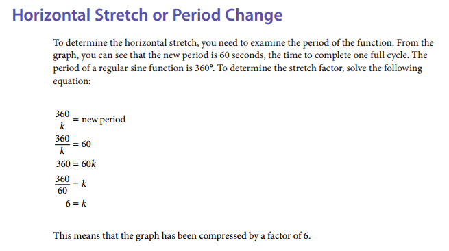

In my post #3 I suggested you should be using radians, not degrees. Have you been taught radians?
No unfortunately I have not been taught this method, although I researched briefly about using radians on my own, but I should probably stick to degrees since that is what the course material has taught me :/
Here is a section from my lesson:
