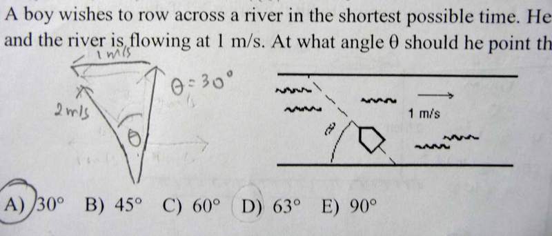

2. A boy wishes to row across a river in the shortest possible time. He can row at 2 m/s in still water and the river is flowing at 1 m/s. At what angle should he point the bow of his boat? (Picture attached, see #2)
A) 30
B) 45
C) 60
D) 63
E) 90
Answer: E

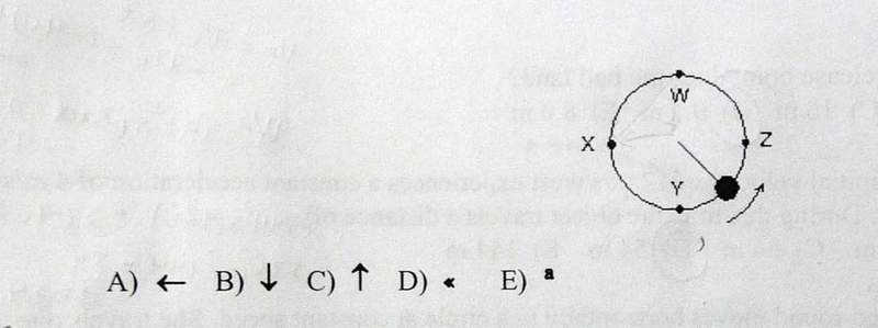

3. An object, tied to a string, moves in a circle at a constant speed on a horizontal surface, as shown. (see attachment titled #3) The direction of the displacement of this object, as it travels from W to X is:
*see attachment #3*
Answer: E

2. See my vector drawing for this problem in the file. I then used arcsin (1/2) to get an angle of 30 degrees. Book says 90. I don't even think 90 degrees makes sense, would it not just push the boat off course and farther away from the destination?
3. I have no idea why this answer would be E, but I'm not sure what a better answer would be, because wouldn't the displacement direction be somewhat diagonal?

2) The question asks for the shortest possible TIME taken to reach the opposite side, it doesn't care how far away on the opposite side you end up. Thus you will want the angle with the largest component pointing towards the opposite bank, which will be 90 degrees.
3) I can't see your attachment yet, but the direction of displacement between 2 points would be the straight line joining them. Displacement is independent of the path taken.

2) Why does the largest component pointing toward the opposite bank allow for the shortest possible time?
3) If you can see the attachment now, the answer choices seemingly make no sense to me. My answer would have been what you said, but it appears that that is not a choice.

2) The time taken to cross the river would be the width of the river divided by the velocity component in that direction, right? The velocity component parallel to the river doesn't matter here as it doesn't contribute to getting you across the river.
3) Eh, 3 choices are arrows, the 4th is a double arrow (what's that supposed to mean?) and the 5th is a letter "a". Hmmmm?
