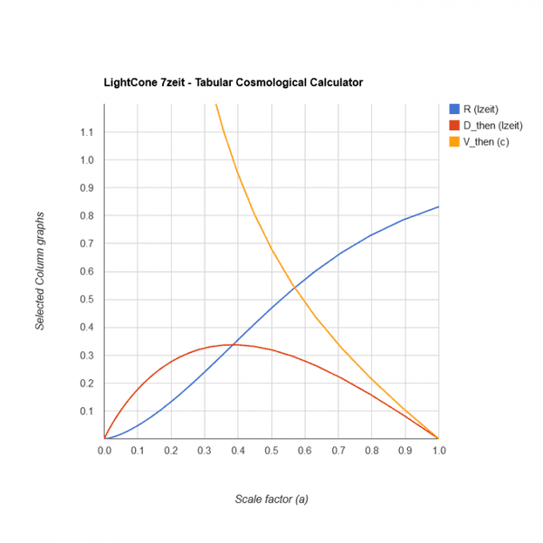

Another way is to look at the Hubble radius (blue curve) versus our past lightcone (the red curve), graphically shown below.
The gold curve is the proper recession rate and one can easily see that where our past lightcone enters the Hubble radius, the recessing rate against scale factor drops through 1, the speed of light. It happens at a ~ 0.38. The units zeit and lzeit are normalized through dividing by the (constant) long term Hubble time, 17.3 Gly.
