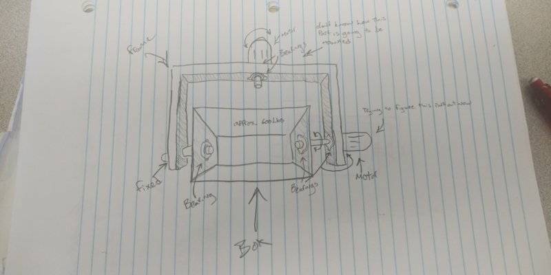

Here is quick sketch of what I'm getting at. As far as my background I am going through an electronics engineering technologies course with Lincoln tech. Its an accelerated program for electronics technicians. So far my course have been basic and specific math in regards to electronics and theory in the same manner. So we will receive a course on physics in a later term but I haven't gotten there yet. I don't believe they will cover it in the way a traditional school will either.
I will have to think more about what I am doing in order to answer the previous questions. I work fulltime on top of school. I'm an industrial mechanic so some of this is not necessarily foreign to me but I have no mechanical or mechatronics schooling only on the job training. I have a lot to learn obviously.
My final project for school is going to be taking data from an accelerometer via a radio signal and sending it to a motor controller to rotate this box. I have about 3 weeks until my prpjects abstract is due which is why I'm looking into all of this now.

Thanks for the sketch, it's a big help. :smile:
Can the horizontal axle go all the way through the box, or will it only contact the two sides as shown? If it only contacts the two sides, the loading on those bearings will be quite high and hard to manage, IMO.
And when you say you need to be able to do one full horizontal rotation per second, is that after a spin-up period of, say, 30 seconds, or do you need to be able to go from a full stop all the way through one turn in one second. If the latter, that is going to take a very powerful motor...
You can simplify your design by using one of these gear reducers to support the box: https://alpha.wittenstein-us.com/pr...273.511492982.1540936180-789768976.1540936180. They are designed to support overhung loads, so you can support the box without needing an outboard bearing. Just size the reducer to handle both the peak drive torque and the overhung load.
The axle cannot go through the box. And the rotation would need to be from a dead stop so yes a very powerful motor is what I am anticipating...and exspensive I am sure.

Since you are an EET, not a senior in ME, we can do some calculations for you.
Assume 600 lbs rotating mass that is, on average, 2 feet from the center of rotation. The moment of inertia (sorry about the English units) is 600 / 32.2 * 2^2 * 12 = 895 in-lb-sec^2.
Assuming start from dead stop, rotate one revolution to a dead stop in one second: Acceleration = 2 * PI / 0.5^2 = 25.1 rad/sec^2.
Maximum velocity = 25.1 rad/sec^2 X 0.5 sec = 12.6 rad/sec = 120 RPM.
Torque = 895 in-lb-sec^2 X 25.1 rad/sec^2 = 11,250 in-lbs = 9400 ft-lbs.
Peak power = 9400 X 120 / 5250 = 22 hp = 16 kW.
Assume a 20:1 ratio gear reducer, then the required motor torque is 11,250 / 20 = 563 in-lbs, and peak motor RPM is 20 X 120 = 2400 RPM.
Tentative motor choice is Allen-Bradley MPL-B560F, rated 600 in-lbs peak torque and 3000 RPM peak speed.
If you want to see what's available for servomotors, check this document on page 79: https://literature.rockwellautomation.com/idc/groups/literature/documents/td/knx-td001_-en-p.pdf. The MPL-B560F is a middle size motor in their middle size servo motor line. If you want to drive big loads, their big HPK series servo motors are on page 139.
Siemens has a similar line of servo motors.
Likes CWatters, Jason mayak and berkeman

Seeing the two powered perpendicular axes in the diagram immediately raises the need to assess the gyroscopic effects on the motors, bearings and structure. You may be able to ignore those effects if it is used as a slow positioning system, but not if it is a continuous rotation system such as a rotary molding machine.
