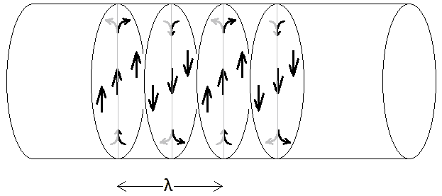

I am trying to sketch the electric field E in snapshot of a linearly polarized laser beam. Is it correct that the E vectors bend from vertical to longitudinal near the cylindrical surface of the beam, and that all field lines within a half wave segment are closed loops?
The electric field lines do not bend at the "top" or the "bottom". The electric field is stronger at the center and weakens as you move from the center to the border, but it always points in the same direction.
The electric field cannot weaken along a field line, if the electric field is vertical everywhere. ##\nabla \cdot \mathbf{E} = 0## in the absence of electric charges (Gauss' law).

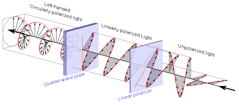

does this help ?
r.Polarization.Circularly.Polarized.Light_Circular.Polarizer_Creating.Left.Handed.Helix.View.svg.png

I can't reconcile that with a narrow beam in free space and each E field line around a radiating dipole follows a curve in a plane. The field strength in any particular elevation will follow a Cos θ law for a short dipole. A collinear / coaxial array will produce a more vertically directional pattern but, being the sum of dipole patterns, why would the E vector direction change? The same thing should apply for a very narrow beam, wouldn't it?
BTW The diagram at the top looks more like the fields in a circular waveguide (conducting walls). That wouldn't be the same boundary conditions as for a narrow beam in free space.

I don't think polarization is the essence of my question. For me, the advantage of specifying the laser beam is linear polarized is that it is slightly simpler to describe and draw than other options.
The essence of my question is that I am wondering about the profile of the electric field on cross sections of the laser beam, and what the field lines look like, given that somehow they should be closed loops because of Gauss' law.

I am afraid I do not understand your answer. My question is about a laser beam in free space, outside the optical cavity. I don't see how or why radiating dipoles are present in that laser beam in free space.
the confusion is because the drawing you supplied implies light in a waveguide ... optical fibre, NOT free space
Ok, but I am actually more interested in a laser beam in free space. Gordianus suggested the laser beam in free space is identical to an infinitely wide plane wave, multiplied by a gaussian-like beam profile in the cross sectional plane. My objection against that suggestion is that it makes ##\nabla\cdot\mathbf{E}## nonzero. Do you think this objection is invalid?

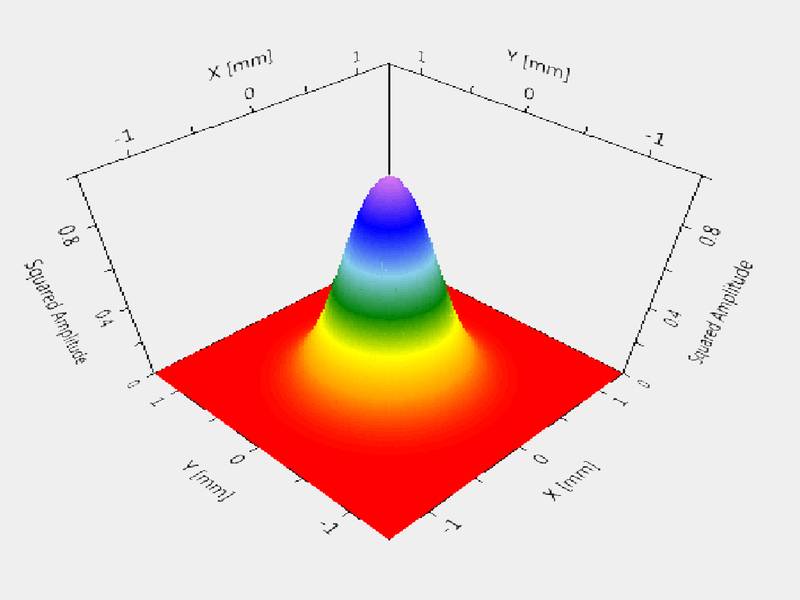

I think the confusion comes because you are trying to use too "big" of a probe to measure the E-field at various points in the beam. Cosnider using a probe that is much smaller than the diameter of the beam. As you move that linearly polarized probe from the center of the beam toward the edge, you measure the Gaussian drop-off of the amplitude of the linearly polarized E-field. The polarization remains the same, just the amplitude drops off.
Like if the beam were aimed vertically in the plot below of E-field squared amplitude versus radius...
http://www.wavelength-tech.com/images/Top%20Hat%20Profile.jpg
The problem I was trying to address, as mentioned in post #9, is more elementary. It does not involve measurement probes. Multiply a linearly polarized plane wave with a gaussian beam profile. The result is that ##\nabla\cdot\mathbf{E}## is nonzero everywhere (except at the axis of the beam). That is incompatible with free space, where charges are absent.

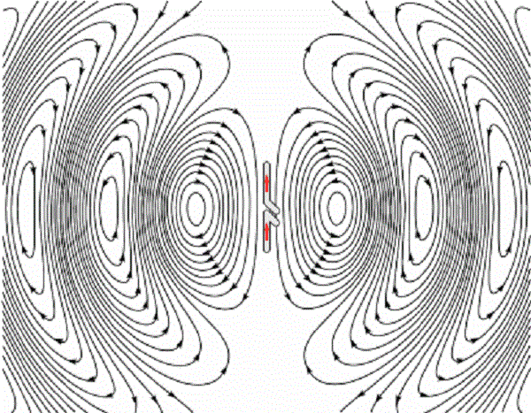

I found this link and it has a diagram which accounts for what happens to the E field at the edges of the beams. It gives a ∇.E = 0 because the field vectors follow a curve in the other sense from the one you have drawn in your diagram.

The circles in my diagram just indicate the nominal position of the main beam and some suggested sidelobes.The sidelobes are 180 degrees out of phase with the main beam.
spareine said:
I see, so all field lines are closed loops around several side lobes. Thanks!
I would say that's not what is going on. If you look at the link on my last post you will see the 'loops' in the antenna fields are not in the plane of the advancing wave front but they double back at the edges of the beam and join to field lines of the previous and next wave front. It is easier to look at the coarser structure of an antenna pattern than to try to draw on the scale of light waves. That also allows ∇.E to be zero without disturbing the polarisation at the edges. The field lines spread out, signifying a lower field at the edges.

I have shown a general case of a beam of EM radiation from an aperture. There are different sorts of illumination of the aperture, which may be dipole-like, loop-like or a mixture and they have different cross polarisation patterns. But in general we expect the field lines at the aperture to be curved due to the characteristics of the source, and this translates into the radiation far field. For linear polarisation, it creates side lobes lying in the 45 degree planes. There are also cross polarised field components in the main beam, but they cancel to zero on-axis.
If the beam is passed through a linear polariser, it will remove the cross polarised sidelobes and will also remove the cross polarised components in the main beam. So there is a small loss of energy. At large angles from the axis of the polariser, geometry appears to dictate that cross polarised components will again be observed in the 45 degree planes.
In all these studies, it is important to be careful to understand the type of axes used if large angles are involved.

I can see no reason why that picture is irrelevant to the situation for a very narrow beam. It shows how the fields are less at the edges without any charge being involved. So, off axis, you are seeing E fields that are not actually parallel with the field at the centre - that's cross polarisation and a linear polariser will remove some of the energy.
Can you explain in the diagram how the field arrows can sometimes point towards or away from the source when we have a transverse wave? I don't think these arrows would be detected by an E-field sensor, such as a short dipole, positioned radially from the source.Thank you.

My apologies, not very scientific! I was referring to the diagram in Post 27 from sophiecentaur.
