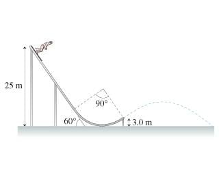

In summary, the question involves a skier, Julie, starting at the top of a 60 degree slope and then going through a 90 degree turn before launching off a 3.0m high ramp. The goal is to determine the horizontal distance of her touchdown point from the end of the ramp. To solve this, energy conservation and kinematics equations are used, with the mass of the skier being a non-factor. The launch angle is not specified in the question.

It's been a great day of new, frictionless snow. Julie starts at the top of the 60 degree slope shown in the figure . At the bottom, a circular arc carries her through a 90 turn, and she then launches off a 3.0--high ramp. How far horizontally is her touchdown point from the end of the ramp?
Ug = mgh
K = 0.5mv2
Kinematics equations
I know I need to use energy conservation to find the kinetic energy at the end of the ramp so I can find the velocity of the skier then, but I do not know how I can find Ug at the top of the ramp without knowing the skier's mass (too many unknowns). Once I know the initial Ug or Kmax I know how to solve the problem, but I'm having trouble getting there.
Never mind the mass, it will cancel. Just use m for the mass or any number you like.
ehild
Thanks ehild, got it.
Just wondering how the launch angle is determined in this question?
