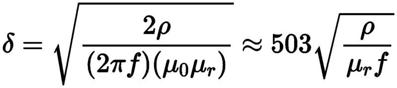

Homework Statement:: Not a specific question, more just a conceptual clarification for a project. But generally:
What is an equation for the effective skin depth of a multilayered (in this case only 2 layers) wire, as a function of the resistivities and relative permeabilities of both of the materials, as well as the frequency of the current?
Relevant Equations:: See below
[Mentor Note -- Thread moved from the schoolwork forums because it is not homework-specific]
I found that skin depth can be approximated as
for good conductors at relatively low frequencies
But what if the conductor in question has multiple layers (say, for example, the surface had begun to oxidize)?
It seems that if the skin depth of the outer layer of the conductor is less than the thickness of said material, the overall skin depth would just be that one skin depth (please correct me if this is wrong, though).
But how can I calculate the effective overall skin depth if it's deeper than the thickness of the outer material?
Additionally, is there a way to quantify the shielding effect this outer layer has?
I would appreciate if the answer would be only in terms of these given variables and constants (i.e., resistivity, relative permeability, and frequency)
This is more of an open-ended question for a project I'm working on, so any background info, clarifications, or suggested references would also be appreciated
Thanks
