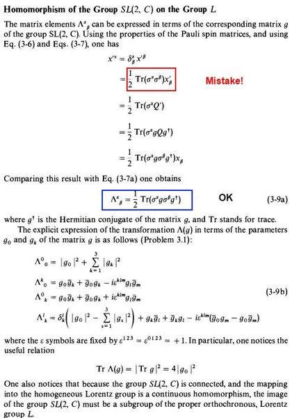

SL(2,C) to Lorentz in Carmeli's "Theory of Spinors"

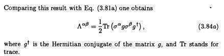

On page 56 of "Theory of Spinors", Eq. (3.84a), Carmeli gives the formula for the Lorentz matrix in terms of Pauli matrices and an SL(2,C) matrix g:
[tex]\Lambda^{\alpha\beta}=(1/2)Tr(\sigma^\alpha g \sigma^\beta g^*)[/tex]
His sigma matrices are the standard ones. It seems to me that there should be [itex]{\Lambda^\alpha}{\phantom{\alpha}}_\beta[/itex] on the LHS. For instance, when g is the identity Lorentz transformation, that is
[tex]{\Lambda^\alpha}{\phantom{\alpha}}_\beta=\delta^\alpha_\beta[/tex]
While with his formula we will get the Minkowski metric matrix instead.
Carmeli's conventions about rising and lowering indices are the standard ones.
I am asking, as I do not want to make some trivial mistake myself while writing my own lecture notes.

[tex] \Lambda^{\mu}_{~~\nu} = \frac{1}{2}\mbox{Tr}\left(\bar{\sigma}^{\mu}g \sigma_{\nu} g^{\dagger}\right) [/tex]
[itex] g\in\mbox{SL(2,C)} [/itex].

Thanks. That confirms my suspicions, since, as I have checked, [itex]\bar{\sigma}^{\mu}=\sigma_\mu.[/itex]
P.S. It is, in fact, not so much "lecture notes", but a book to be published: "Quantum fractals".

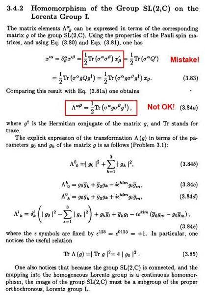

I don’t see any thing wrong with that. The identity in [itex]SL( 2 , C )[/itex], i.e., [itex]g = I_{ 2 \times 2 }[/itex], corresponds to the identity in [itex]SO( 1 , 3 )[/itex]. The Minkowski metric is the identity in the Lorentz group:
[tex]
\bar{ x }^{ \alpha } = \Lambda^{ \alpha \beta } x_{ \beta } = \eta^{ \alpha \beta } x_{ \beta } = x^{ \alpha } = I_{ SO( 1 , 3 )} x^{ \alpha } .
[/tex]

According to Carmeli and Malin formula, for [itex]g=I_{2\times 2}[/itex]:
[tex]\Lambda^{ \alpha \beta }=\delta^{ \alpha \beta } = \mbox{diag}(1,1,1,1)[/tex]
(i.e. Kronecker's delta)
instead of (correct)
[tex]\Lambda^{ \alpha \beta }=\eta^{ \alpha \beta } = \mbox{diag}(1,-1,-1,-1)[/tex]
Yes, the reasoning in 3.83 is wrong, because [itex] \frac{1}{2}\mbox{Tr}\left(\sigma^{\alpha}\sigma^{\beta}\right) = \delta^{\alpha\beta} [/itex], but
[tex] x'^{\alpha} \neq \delta^{\alpha\beta}x'_{\beta} [/tex]

Yes, the reasoning in 3.83 is wrong ...
Thank you. That is also where I have detected the mistake in the derivation.

There is no such object in Minkowski space. When it comes to the Lorentz group, I very much trust Carameli. Also, I know the book in question and I do not remember any such blunder. I guess you are unfamiliar with their conventions or/and calculating the TRACE in a naïve way. When we write the relation
[tex]\sigma^{ \mu } \ \sigma^{ \nu } = - \eta^{ \mu \nu } + 2 i \sigma^{ \mu \nu } ,[/tex]
what we really mean is the following [itex]SL( 2 , C )[/itex] realation
[tex]
\left( \sigma^{ \mu } \right)_{ A } {}^{ \dot{ B } } \left( \sigma^{ \nu } \right)_{ C \dot{ B } } = - \eta^{ \mu \nu } \epsilon_{ A C } + 2 i \left( \sigma^{ \mu \nu } \right)_{ A C } , \ \ \ (1)
[/tex]
where (and this is important)
[tex]\left( \sigma^{ \nu } \right)_{ C \dot{ B } } = \left( \bar{ \sigma }^{ \nu } \right)_{ \dot{ B } C } , \ \ \ (2)[/tex]
[tex]\left( \sigma^{ \mu \nu } \right)_{ AC } = \left( \sigma^{ \mu \nu } \right)_{ C A } , \ \ \ (3)[/tex]
and
[tex]\epsilon_{ A B } = \epsilon^{ A B } = \left( \begin{array} {cc} 0 & -1 \\ 1 & 0 \end{array} \right) . \ \ \ (4)[/tex]
Now, to calculate the trace of [itex]\sigma^{ \mu } \sigma^{ \nu }[/itex], we contract Eq(1) with [itex]\epsilon^{ A C }[/itex] and use Eq(3) and Eq(4)
[tex]
\mbox{ Tr } \left( \sigma^{ \mu } \sigma^{ \nu } \right) = \epsilon^{ A C } \left( \sigma^{ \mu } \right)_{ A } {}^{ \dot{ B } } \ \left( \sigma^{ \nu } \right)_{ C \dot{ B } } = - \eta^{ \mu \nu } ( - 2 ) + 0 = 2 \eta^{ \mu \nu } . \ \ (5)
[/tex]
Now, if you naively take [itex]\mu = \nu = 1[/itex] in the above equation, you find [itex]2 = - 2[/itex]. This is because you are not taking Eq(2) in the consideration. What you should do is the following
[tex]
\mbox{ Tr } \left( \sigma^{ \mu } \sigma^{ \nu } \right) = \left( \sigma^{ \mu } \right)^{ C \dot{ B } } \ \left( \sigma^{ \nu } \right)_{ C \dot{ B } } = \left( \sigma^{ \mu } \right)^{ C \dot{ B } } \ \left( \bar{ \sigma }^{ \nu } \right)_{ \dot{ B } C } ,
[/tex]
where [itex]\bar{ \sigma }^{ \nu } = ( I , - \sigma^{ i } ) .[/itex]
You said the book writes [itex]\Lambda^{ \mu \nu} \in SO( 1 , 3 )[/itex] as
[tex]\Lambda^{ \mu \nu } ( g ) = \frac{ 1 }{ 2 } \mbox{ Tr } \left( \sigma^{ \mu } g \sigma^{ \nu } \bar{ g } \right) .[/tex]
Therefore, for [itex]g = \bar{ g } = I \in SL( 2 , C )[/itex], you get
[tex]\Lambda^{ \mu \nu } ( I ) = \frac{ 1 }{ 2 } \mbox{ Tr } \left( \sigma^{ \mu } \sigma^{ \nu } \right) .[/tex]
Now, if you compare this with Eq(5), you find that
[tex]\Lambda^{ \mu \nu } ( I_{ 2 \times 2 } ) = \eta^{ \mu \nu } = I \in SO( 1 , 3 ) .[/tex]
So there is no such object as [itex]\delta^{ \mu \nu }[/itex].
Sam

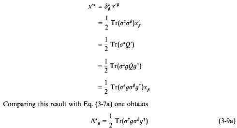

Hi Sam,
as usual your argument is impeccable. Indeed, I've overlooked something:
[tex] x'^{\alpha} = \delta^{\alpha}_{\beta}x'^{\beta} = \delta^{\alpha}_{\beta}\eta^{\beta\lambda}x'_{\lambda} = \eta^{\alpha\lambda}x'_{\lambda}[/tex]
therefore
[tex] x'^{\alpha} =\eta^{\alpha\beta}x'_{\beta} [/tex] (as expected, no delta).
and the proof that
[tex] \eta^{\alpha\beta} = \frac{1}{2}\mbox{Tr}\left(\sigma^{\alpha}\sigma^{\beta}\right) [/tex]
is exactly how you wrote it, because of the [itex] \epsilon [/itex] metric tensor being antisymmetric for SL(2,C) as opposed to symmetric for SU(2).

Yet
[tex]\eta^{11}=-1[/tex]
while
[tex]\frac{1}{2}\mbox{tr}(\sigma^1\sigma^1)=1[/tex]
Therefore
[tex]1=-1[/tex]
So, we are getting a contradiction.

In "Theory of Spinors" , 2000, (with Malin) , Ch. 3.4.2, p. 56 (3.84a):
[tex]\Lambda^{\alpha\beta}=\frac{1}{2}\mbox{Tr }(\sigma^\alpha g\sigma^\beta g\dagger).[/tex]
In "Group Theory and General Relativity", (1997), Ch. 3-1, p. 36 (3-9a)
[tex]\Lambda^{\alpha}_{\phantom{\alpha}\beta}=\frac{1}{2}\mbox{Tr }(\sigma^\alpha g\sigma^\beta g\dagger).[/tex]
The same context, the same definitions, the same notation: [itex]\alpha,\beta=0,1,2,3[/itex], [itex]g[/itex] is SL(2,C) matrix, [itex]\Lambda[/itex] - the corresponding Lorentz matrix, [itex]\sigma[/itex] - Pauli matrices, [itex]{}^\dagger[/itex] - Hermitian conjugate of a matrix, Tr - trace of the matrix.
The difference is the eta matrix (Minkowski metric)
[tex]\Lambda^{\alpha}_{\phantom{\alpha}\beta}=\Lambda^{\alpha\rho}\eta_{\rho\beta}.[/tex]
At least one of the formulas must be wrong. My contention is that the second formula is right, the first one is wrong. Probably other readers will be also puzzled, will google, and will come to this thread. So, we should reach a clear consensus - which one is right and which one is wrong.

Checked both. Both give the second formula. (Their sigmas with lower index are exactly the same as Carmeli's sigmas with upper index - up to an irrelevant here sign of [itex]\sigma^2[/itex]).
The other sources I've checked use sigma bar. They also reduce to the second formula.
In fact the derivation is straighforward.
1) Define [itex]\Lambda[/itex] in terms of an SL(2,C) matrix [itex]A[/itex] by
[tex]A\sigma_\mu A^\dagger=\sigma_\nu\,\Lambda^\nu_{\phantom{\nu}\mu}[/tex]
2) Check that
[tex]\mbox{Tr }(\sigma_\mu \sigma_\nu )= 2\delta_{\mu\nu}[/tex]
3) Multiply the first equation by [itex]\sigma_\rho[/itex] and take the trace of both sides. Use the second equation. Rename the indices.
