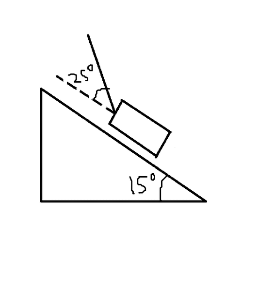

A child pulls a 3.6 kg sled at 25 degrees to a slope that is 15 degrees to the horizontal, as in the figure. The sled moves at a constant velocity when the tension is 16 N. What is the acceleration of the sled if the rope is released?
F=ma, f=[itex]\mu[/itex]N
Constant velocity means that friction + the component from Fg shall equal FTx (tension component parallell to plane) that is FTx = f + Fx
Where FTx=cos(25)*FT=14.5 N and Fx=3.6*9.8=9.13 N
Now I want [itex]\mu[/itex] so that I can calculate f. And we know that N=cos(15)*mg+T*sin(25)=40.84 N
If we go back to the start, FTx=[itex]\mu[/itex]N+Fx so [itex]\mu[/itex]= [itex]\frac{ (FTx-Fx) }{N}[/itex]= [itex]\frac{14.5-9.13}{40.84}[/itex] = 0.131
When we release the sled N will reduce to N=mg*cos(15)=34.08 and so f=0.131*34.08=4.46 N
Fres=Fx-f=9.13-4.46=4.66 N
And the acceleration is a=[itex]\frac{F}{m}[/itex]=[itex]\frac{4.66}{3.6}[/itex]=1.3 m/s^2
But apparently this is not correct. Could someone please tell me what I've missed, this question has been very frustrating for me :(
Also, negative signs tend to mess upp my Latex, I apologize.
Here's the figure btw.

Anyone?
According to the answer sheet the correct answer should be 0.67 m/s^2 but I'm starting to wonder whether that's true or not?
