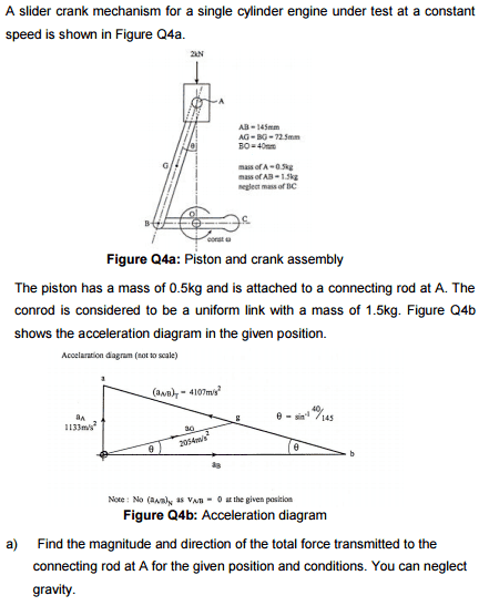

Slider Crank Magnitude and Direction of Force on Member AB

The acceleration diagram gives you the acceleration of the various bits. You also have the masses. The rest is trig. For example, the piston is accelerating in a straight line. Because the connecting rod is at an angle to the direction of piston travel there is a force component perpendicular to the direction of piston travel and another along the direction of piston travel. Those forces act on A in the direction along the connecting rod.
