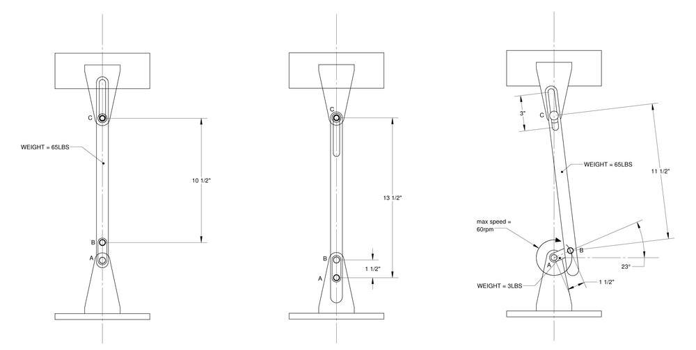

I hope that it is okay for me to ask this here. It has been a long time since i did mechanism analysis.
I have what I hope is a quick question. I calculate the torque required to rotate crank AB and therefore lift up the link BC to be 88lb-in. I assumed that link AB has no weight, no friction at the joints and i kept the length of BC at 10.5". I am trying to determine the minimum motor size i need to lift link BC, with link AB moving at a maximum of 60rpm.
I know i am also missing the inertia load to start the rotation. But i am just going for a ball park torque figure for now.
Thanks in advance for your help.
  • sample data.xlsx
You can start by looking at the values in your "Torque at theta" row, and ask if they make sense. Then look into how your spreadsheet calculates trig functions.
Hint: Consider the difference between degrees and radians.
Thanks. I have updated the equations to using radians, but it didn't change the torque at all. It would make more sense to me for the torque required to be 89lb-ft, not 89lb-in.
I am trying to solve this with trig. But my problem is that it doesn't seem like the usual slider crank mechanism, with the slider able to pivot. But in my design, I need the long link to pivot.
Strange ! It did make a big change for me: from
to
or one period of a sine when plotted. Makes a whole lot more sense.
But this is the static torque at 0 rpm !
to
Ah ok, yes sorry. I meant that the max torque didn't really change.
