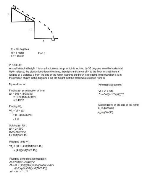

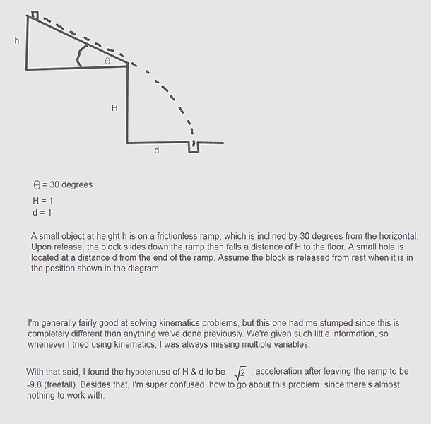

In summary, the problem asks for the horizontal and vertical components of velocity at the end of the ramp. The equation to solve for is Δh = (49/20)t^2. This yields Vfy as a function of Δh. Plugging in Vfy into the first equation, I get Vf as a function of Δh. Finally, using Vf and the angle at the end of the ramp, I can solve for h.
Shaku
46
I typed this up on MP's Whiteboard, but the tutors were taking way too long to respond:
(question is also attached)
Edit:
Units are in meters.
Questions asks to Find h (small h defining the height of the ramp).
The exact moment the object leaves the ramp, it would have components Y=gsin(30) and X=gcos(30).

Yeah, I already tried that -- but I'd still be missing variables to do anything useful with the x and y components. It would be gsin(30) but I'm not sure where to go from there.
Units are in meters, and the problem has to solve for h (the small "h" defining the ramp's height).
In terms of h, what will the horizontal and vertical components of velocity be at the end of the ramp? (You can either determine the acceleration down the ramp or use conservation of energy.)
gsin(30) and gcos(30). But what am I supposed to do with that information? I'm still confused as we're supposed to reach an actual numerical answer for h.

I'm confused again... I tried:
Plugging t into distance equation:
Δs = Vi(t)+(1/2)(a)(t)^2
Δh = 0 + (1/2)(gSin(30)(sqrt(Δh/2.45))^2
=(1/2)(gSin(30)(sqrt(Δh/2.45))
Δh = Δh ...?
Could you clarify what variables I'm trying to solve for, and how I'm supposed to solve for them? I tried a few different ideas, but I always ended up with strange numbers/variables that didn't work.

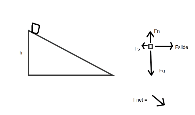

Here's what I have so far:
Let's back up here for a moment. Just realized I didn't check something you wrote earlier: you gave the components of the acceleration as gsin(30) and gcos(30). They're wrong.
Draw the free body diagram of the block. What are the forces on it?

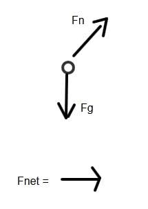

How would I figure out the force? The problem didn't give a weight. Fnet = ma would leave me with two variables again.
Don't worry about the mass. Let it be m. It will cancel out later.
Your force diagram is wrong. Which way does the normal force act? There's no friction, so forget Fs (and anyway it would have been Fk). What's Fslide??

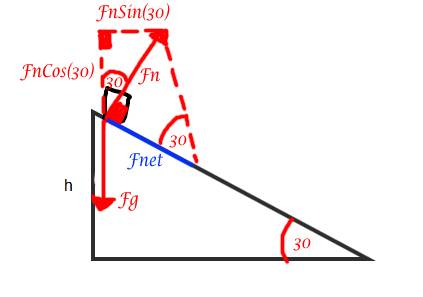

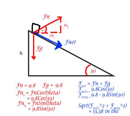

Sorry, I just recently started on forces. This new diagram should be correct, having no friction. Just Fn and Fg. -- The Fslide on the old diagram was just a mistake. I forgot that there are no forces acting on it since there are no forces which are physically touching the object (unless it's a long-range force).
Fnet = ma
Fynet = m(gSin(30))
Fxnet = m(gCos(30))
Is this correct? I'm not sure since you said gSin(30) & gCos(30) wasn't the acceleration... I don't know the force nor the mass to figure out acceleration if I needed to otherwise.
Shaku said:
Fynet = m(gSin(30))
Fxnet = m(gCos(30))
The diagram is right now but those equations do not spring from it at all. What happened to the normal force? How does g get a horizontal component?
Let's try it again, one step at a time:
- what is the component of Fn in the vertical direction?
- what is the component of Fn in the horizontal direction?
- what is the component of Fg in the vertical direction?
- what is the component of Fg in the horizontal direction?
9.8 (Since Fn is opposite of g).
I'm not sure... since you said this wasn't gCos(30), but that's the only way I see that I can get this force.
-9.8 (gravity)

Edit2: Just realized my math was wrong for Fnety.
Should be:
9.8Sin(30) - 9.8 = 4.9.
Edit3: Also just realized this doesn't work either... It just = 9.8 again... Sigh. I need help ><

The acceleration will have a vertical component, so you can't assume the forces balance. At this stage, I'm not asking you to equate forces. My question is much simpler: if the normal force is Fn, and the slope is 30 degrees, what is the component of Fn in the vertical direction?
Similarly my other questions.

In that case it would be:
Fny = FnSin(30) (Since slope is Fn, angle is 30, and we're looking for the opposite)I was talking to a friend earlier today, and he said that the force at the end of the ramp would be gTan(30), and then you'd use that to somehow work out the problem. I'm still completely lost though...
If he's correct, then Fny = gTan30*Sin(30)... But that seems like a really small force (~0.28867 Newtons), so I doubt that's correct.
