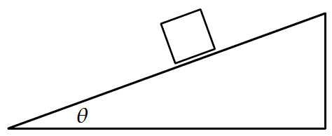

Hi, friends! A block having mass ##m## frictionlessly slips from height ##h## on a ramp of mass ##M##, which has an angle ##\theta## with the floor, where it slips with no friction.
I would like to prove that, as my book says, the ramp's speed when the block leaves it is
##V=\sqrt{\frac{2m^2gh\cos^2\theta}{(m+M)(M+m\sin^2\theta)}}.##​
But I cannot reach this result. Because of the conservation of momentum in the direction parallel to the floor, which is a direction where no external force act on the system block-ramp, I would say that the speed ##v## of the block when it leaves the ramp is such that ##mv\cos\theta=M V## and, because of the conservation of mechanical energy, I would think that ##mgh=\frac{1}{2}mv^2+\frac{1}{2} MV^2=\frac{1}{2}\big(\frac{M^2V^2}{m\cos^2\theta} +MV^2\big)##, and therefore ##V=\sqrt{\frac{2m^2gh\cos^2\theta}{(m+M)(M^2+Mm\cos^2\theta)}}##
which is a wrong result. Where am I wrong?
I ##\infty##-ly thank you for any help!
Where do you get the (m+M) term?

Relative to the ground, what direction will the block be moving?

See thread https://www.physicsforums.com/threads/wedge-and-block-initial-momentum.806992/. It is the same problem as yours.
Decide what you denote by v. The block slides on the ramp which is moving horizontally with velocity -V. If the relative velocity of the block with respect to the ramp is u, the horizontal component is ucos(θ) and in the rest frame of reference it is ucos(θ)-V.
Likes DavideGenoa
Thank you all, friends! ehild's linked post answers the issue.
