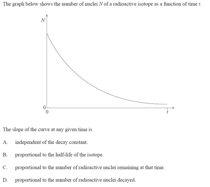

##N=N_o e^{-\lambda t}##
I am not really sure how to interpret the slope. The equation is:
$$N=N_o e^{-\lambda t}$$
If the graph is N against t, then what is the slope?
I can find the slope if the graph is log:
$$log N=log N_o -\lambda t$$
So if the graph is log N against t, then the slope is ##-\lambda##
But if the graph is N against t, I have no idea what the slope is.
Thanks
Are you familiar with derivatives?
Yes. I understand your hint.
Thank you very much Orodruin
