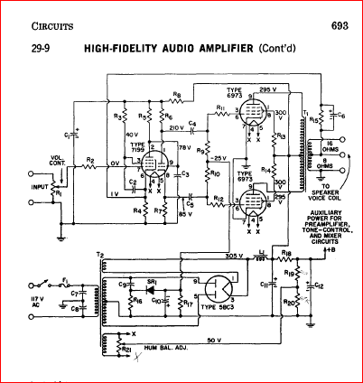

Hey,
Im in the process of building my final project for an engineering electronics course.
The requirements:
- 3 Inputs
- mixer stage
- driver stage 0.5 - 3watts ( my speaker is 3 watts)
- output to 8 ohm speaker.
Questions
- Anyone have any good links regarding helping pick BJT, Jfet or Mosfet for pre-amp stage? I know from recording music they sound different but does anyone have any technical papers or good explanations?
- I don't know which I should build for driver stage. Its recommended to do a BJT push pull a/b amp. Since I'm a recording/guitar guy I really like tubes. Anyone have any low wattage tube driver schems?
Any recommendations would be appreciated.
thanks

When you say "driver stage" I think you mean output stage. Usually, a driver is the stage before the output.
If you want to use a tube output, very good audio can be obtained for small powers from a single ended beam tetrode in Class A, such as the EL84, without using push-pull. But if you want to over-drive the output stage intentionally to obtain a traditional electric guitar sound, I believe the use of triodes is recommended so that the overload point is more gradual. Such tubes, however, involve much more cost and a more complex driver stage as the drive requirement is much greater. Incidentally, as an engineer, I am not prepared to accept that things sound different when I cannot see it on a CRO.
RCA Tube Manual has a LOT of hobbyist audio circuits in last section. Below is a snippet from the RC30 edition of RCA Receiving Tube Manual which i downloaded from someplace. Google or Bing will find it...
You will find the tubes and transformers pretty expensive nowadays .
If you can find a trove of old not working tube radios and TV's to pillage it'd help.
In high school(1963) i built this amplifier , used it for years .
Everybody uses integrated circuit amplifiers these days. Look up LM386.
You can buy throwaway computer speakers for just a couple bucks in thrift stores.
I learned a lot by taking them apart and looking up datasheets for the IC amplifiers inside.
GE's transistor manual from about 1964 is a good "how to" book for bjt circuit design. It too is out there in pdf.
Good luck in your studies,
old jim
The push pull amplifier shown will have less even order distortion than my suggestion for a single ended Class A beam tetrode. However, I would, be very surprised if this is audible or objectionable, and the additional complication and cost is very great.
All 3 of those points are true.
That amplifier had wonderful sound.

Thanks for all the information.
If I stray from valve (since I have a time constraint)
what is a backup plan for a power stage?
I was thinking push-pull discrete transistor but am open to suggestions.
(again simpler)-This information is amazing though because one of my summer projects is refurbishing a tube amp I ripped out of a old vinyl cabinet.
If Its not really worth saving, I'll probably just build one. I am researching the math involved though as I'd like to learn tube design instead
of just whipping a circuit together.Again thanks for replies.
