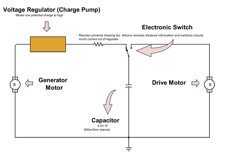

The only diode is a Schottky. We have a voltage regulator to try to fix the voltage problem but it doesn't seem to help the charging rate at all.

and the pic of our regulator circuit (box)

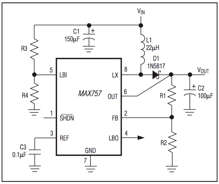

Most charge pumps can only supply small currents.. this could be a problem because it can't supply the current to charge the capacitor in time.
If you're really going to use 2 motors, one to generate the power and the other to drive the vehicle, perhaps choosing a 12V motor as a generator will provide the desired 5V to charge the capacitor much easier since it won't have to turn as fast...
I think the first thing to be done is determine which side is causing the problem.. check the voltage across the cap at the bottom of the hill, and check the specs for how much current the charge pump can deliver.. If it's 10ma and your trip down the hill only lasts 2 seconds, it's no wonder you aren't able to drive anywhere after..

that resistor will cause problems.
also the part you are using is not designed to work for up to 12 V.
what is your plan if the generator produces 12VDC?
take a look at this, and look up parts like it. http://www.ti.com/tool/TIDM-BUCKBOOST-BIDIR
one thing you can do is provide a boost converter (might need to be a buck boost depending on the voltage you want and the cap voltage). This will provide a slightly more linear power supply to the drive motor until the capacitor depletes. which is why you can use a bidi converter to save parts.
alternatively you can use one converter single direction from the generator, and one converter single direction to the drive motor
