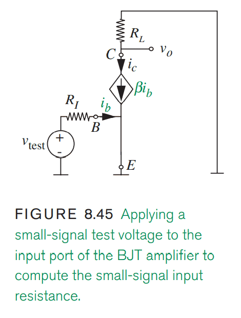

Find the small signal input resistance to a BJT amplifier.
iB = Vtest / Rinput
iC = beta x iB
The diagram of the BJT amplifier small signal model is below. This is not really a homework question as I am self-learning electronics, but I was advised it may be better placed here than in the technical portion of the forum. Thus I do not have an "attempt" at a solution (which is given as RI or Rinput by the text example), but rather some ruminations as to why the answer is what it is. I understand that generally, the input resistance in the presence of dependent sources can be measured as a ratio of Vtest to the produced current. However, I do not understand why we measure only the current iB (which is Vtest / Rinput according to Ohm's law) versus either iC (which is beta x iB per the constituent relation) or iE (which is iB + iC). That is, what is the strict definition of the "produced current" in this case? Since there are multiple currents generated by the voltage Vtest, why is it that only the one through the input resistor branch matters? Thanks in advance!

anvoice said:
Homework Statement:: Find the small signal input resistance to a BJT amplifier.
Relevant Equations:: iB = Vtest / Rinput
iC = beta x iB
This is simply the definition of "input resistance". Yes, there are other things to measure too, but they would be called something else. Input resistance is always the input voltage divided by the input current, that is all. If you want to learn more you could look into "h-parameters" or "Z-parameters" of transistors or networks.

While the previous answers were more accurate and detailed, one way of interpreting the circuit you supplied is:
To a first level of approximation all wires have Zero resistance, therefor the "B" terminal is directly connected to VTEST minus.
That works for this particular diagram because the intrinsic resistance of the Emitter is ignored. As you get to more detailed analyses, the Emitter resistance shows up just above, and in series with, the "E" terminal.

The expression β * Re is a rather rough approximation ...what happens for RE=0 (as in the question)?
In this case (RE=0), the remaining resistance is the small-signal resistance between base and emitter (rbe).
For calculating this resistance rbe we use the definition:
rbe=d(Vbe)/d(Ib) which also can be written as
rbe=[d(Vbe)/d((Ic)]*[d(Ic)/d(Ib)]=(1/g)*β=β/g
with β=small signal current gain and
g=transconductance=Ic/Vt
(transconductance g depends directly on the DC collector current Ic and the temperature voltage Vt=26mV (room temperature)
Example: β=100, Vt=25mV, Ic=1mA
rbe=100*25=2.5kOhm

Thank you to everyone who tried to help. I understand that the diagram might not detail a typically used circuit, its virtue is simplicity so I was hoping to at least understand that. I will definitely try to understand the common emitter fully, along with the approximations made, when I come to it.
It seems though that I am missing something fundamental. If the input resistance is the "resistance seen by the current source or voltage source which drives the circuit" (is that right?), then don't we need to choose two points at least to observe the said resistance (e.g. between the + and - terminals of the test voltage source in the diagram)? Since currents flow in loops (and through branches), and voltages are observed between two points? Then, why do we have to choose specifically the branch connected directly to the positive terminal of the test voltage, observe its current before it joins the collector current to form the emitter current, and conclude that the input resistance "seen" by the voltage source is just RI (Rinput)? Sorry if I'm rephrasing previous statements, but I just don't understand the concept with the information previously given here or in the text.
Correct. The input current or voltage source is referenced to ground, common, or earth.
A voltage source is assumed to have zero resistance, while a current source has infinite resistance.
Hi again @anvoice,
"Input Resistance" should perhaps be called "Equivalent Input Resistance."
Renaming it with "Equivalent" points out that, if instead of connecting VTEST to the transistor you connect a resistor of the same value across VTEST, then the voltage and the current of VTEST will be the same as if the transistor were connected there.
And yes, the various currents in a transistor DO interact, and that is what the equations above that include β show. Those equations are the next step of complexity to more accurately understand/describe the circuit.
Another fine-point definition: Input Resistance is what any Source connected to an input (of any device) reacts to as a load. If the source is a Voltage source, then as the resistance goes up the current goes down. It doesn't matter if the load is a resistor, diode, or transistor...
... (well -- almost doesn't matter, see the previous paragraph. Diodes and transistors change their apparent resistance depending on how much current is flowing thru each of their pins; that is another way of saying that they are nonlinear devices. But that is another can-of-worms, for much later!)
Hang in there, at some point that light bulb in your head will light up. 😁

That's what's confusing me in the example then. As the current iB from the + input splits, depending on which way you turn to get to ground, the current becomes either -iC or iE. So why are we justified in stopping at the base of the BJT and saying "this is the input current"?
Not quite. The Collector junction is reverse biased so the Base current can't go that way, it flows out the Emitter.
Anyhow, we are talking about the Base as the input, so it doesn't really matter where the current flows after it gets in the transistor. All we need is to know how much current is entering the Base so we can determine the effect on the source voltage, VTEST in the present circuit.
(By the way, just to complicate matters, the circuit as shown would typically be a simplified circuit for finding the AC characteristics of the stage and its loading of the signal source (prior stage).)
Just to avoid misunderstanding on your side:
As far as I can see, up to now we only spoke about the input resistance at the base node.
With respect to the circuit as shown in your first post, there is an external ohmic resistor between the input source and the base node. Of course, when you are interested in the input resistance of the whole circuit this resistor must be added to the resistor which does exist (can be measured resp. computed) at the base node.

anvoice said:
"Yes, I was always thinking about the circuit with that in mind. The external ohmic resistor is what determines the resistance in this case because the resistance of the base itself is theoretically zero (or otherwise really small) if I now understand correctly."
Oh no - that's not correct!
The input resistance at the base node can be several kOhms (when the emitter is ac-grounded) and can be much larger when there is an ac-effective emitter resistor (negative feedback effect).
In my post'6 I gave you an example.
