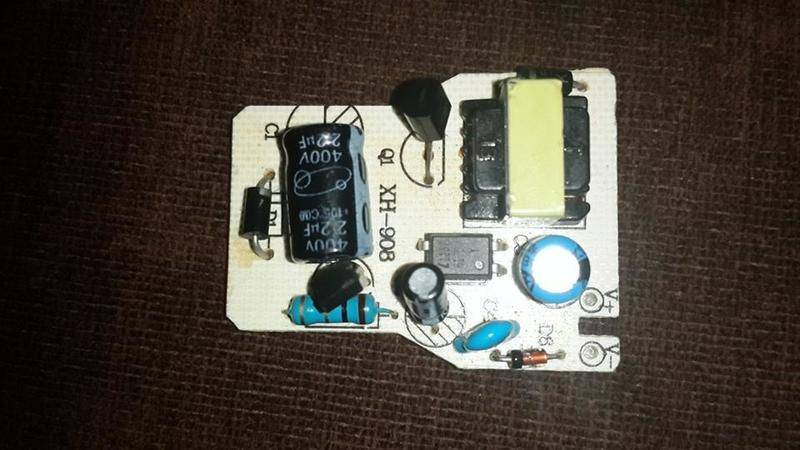

Hello Guys, I am looking for an alternative for the big size electrolytic capacitors. Can you suggest me any alternatives or solutions. I need a small solution with dimensions of 2.2μ, and 440 volt.
Thanks in Advance,

Does the cap need to be non-polar? Or can it be polarized? What is the ripple current (magnitude and frequency)? What is the application?
Thanks Berkeman, The cap would be used in a rectifier circuit that transforms from 110 Ac to 5 volt DC , I am not an electrical engineer, so I don't know if it should be polarized or not (but I think yes).

Why does the cap need to have a voltage rating of 440V if it is just smoothing the 5V output of the transformer?
It should be for a mobile charger, I opened a smasung charger, and an charger apple, and both had a 400v, capacitor, What do you think ?
Well, if they are rectifying the AC Mains input, and then using a DC-DC converter to make the 5V, then I can see a high-voltage polar cap being needed. In your initial post, I assumed that this was a traditional transformer followed by the rectifier and smoothing cap.

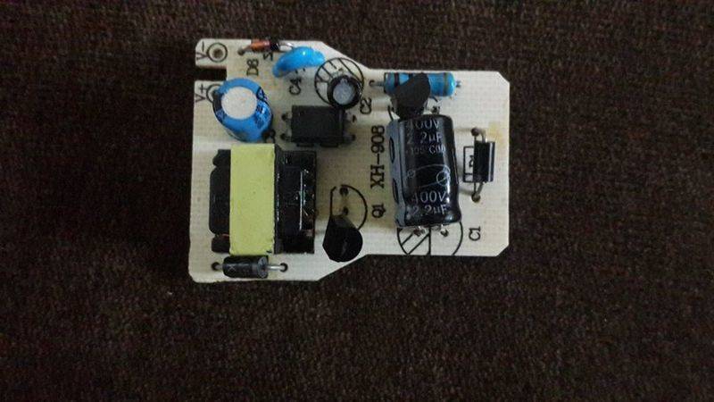

Can you post a picture?
yes of course!
Yeah, that's the AC Mains input storage cap after the half-wave rectifying diode. You won't be able to reduce its size by much from the polar electrolytic that is being used already. For what reason are you looking for a smaller alternative?
I am creating a multi-tasking system with led lights, speakers and charging, and system for a course at the university, and I will use that system, I am kinda copying it. so by that, I understand that no titanium capacitors, or SMT capacitors ? I don't want to do the circuit by my hand, but only a plan of how it can be done, and what it needs

No, that's pretty much the size of it. If you are going to show connection to the AC Mains in your project drawing, be sure to include a fuse in line with the Hot lead, and a power switch in line with the Hot lead. Do not actually build anything that involves AC Mains high voltage connections, until you know a lot more about electronics. It can be very dangerous to work with (shock and fire hazard).

I don't think you can reduce the size of that cap much, especially not knowing what other specs are important for it (like ESR, ripple current, etc.).
A polar cap is usually smaller than a non-polar cap in physical size (for large value capacitors like this one). So if you are dealing with a DC voltage and want smallest/cheapest, yes you use a polar capacitor.

How can I know the circuit design of this pcb? or get anything close to it ? any ideas please ?
reverse engineer it
draw the circuit out, its a very basic circuit :smile:
The only thing you won't be sure of without some serious effort is the number of turns on the transformer windings. Everythuing else is straight forward
You don't need to use this exact circuit, since you say that you are just writing a schematic to do similar things. Use Google Images to look for AC Mains to 5V switching power supplies, and use one of them.
