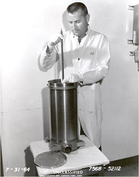

It seems that nuclear reactors can reach quite small sizes though. The SNAP-8 developmental reactor core was a 1 MWt compact sodium-potassium cooled reactor that fed a mercury Rankine turbine (photo source).

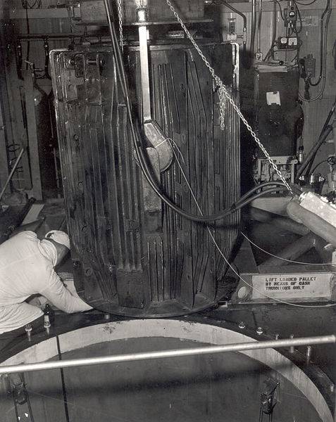

SNAP-8 somehow makes the modular 1.8 MWe PM-3A reactor the United States Army Nuclear Power Program installed at McMurdoo, Antarctica, look bulky (photo source).
