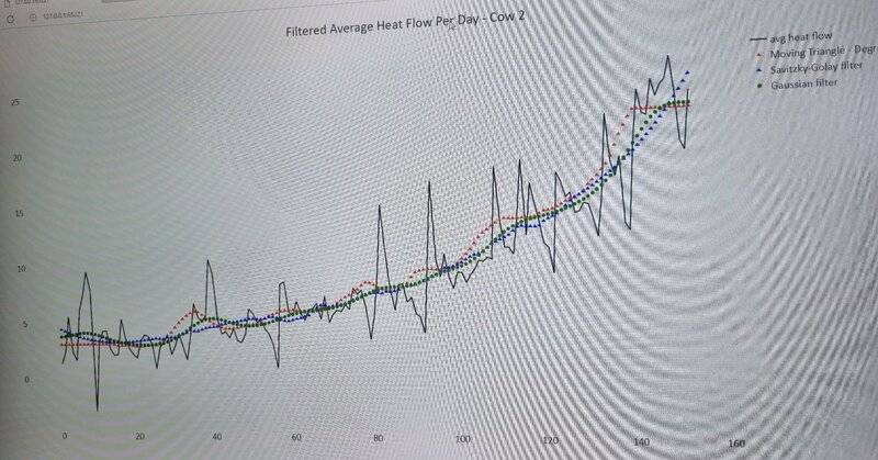

As I promised, here is the data.
The average is what I get from the sensor (heat that exits the ear of the cow, averaged over an hour).
The other graphs have smoothing algorithm applied on the original average graph.
By having the data, if you have more inputs for me to follow, I'd very appreciate it as well. 🙂
Nice job smoothing! How did you do that smoothing?
