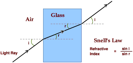

Hello, I don't know how to paste my own pictures on here so I've got some from the internet:https://upload.wikimedia.org/wikipedia/commons/8/85/Refraction_photo.png

A laser light can be used such as from a laser pen or a laser spirit level (used by builders)
