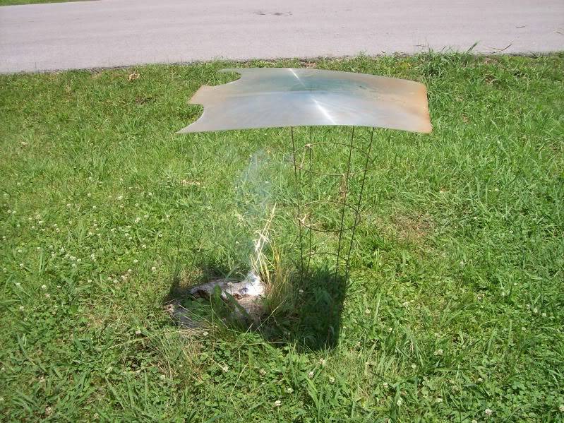

Flame is slow I tried that and it does not kill roots and it does not stop seeds from growing. I have a large fresnel lens i tried it too. A 5000 degree F spot from the sun will vaporize a weed in 10 to 30 seconds after all the water evaporates from the weed this is slow and weeds are scattered all over the yard. I have to hold the fresnel lens by hand wait for weed to burn up then move to next weed. After looking at that bright spot to burn first weed I am blinded and can not find the another weed for 15 minutes. I tried welding goggles it is too much work and too much time involved. The fresnel lens works great to remove tree stumps it is like a 1" wide laser beam burning its way through the stump at the same speed the sun moves. The lens needs to be moved over 1" every day to burn another slot in the stump. Stump is gone in about month.
