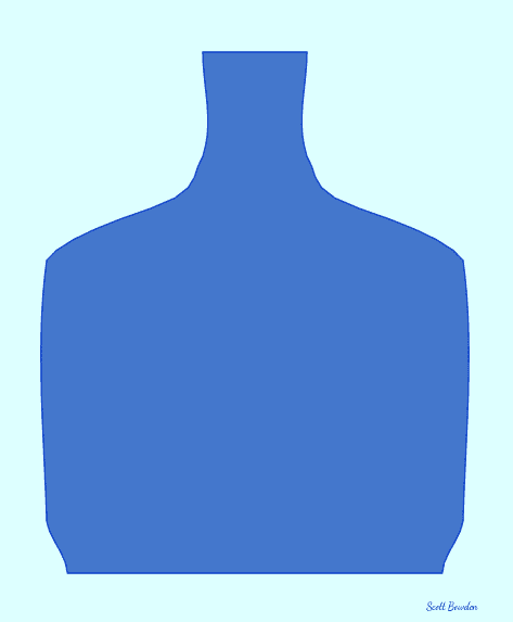

@Einstein44 :
We'll position the bottle so its rotation axis is the x-axis.
The points you have on the bottles surface (inside or outside - depending on which volume you want) will be a series of (x,r) pairs with monotonically increasing x values, such as this:
(0,1.8), (0.5,2), (3,2), (3.5,1), (4,0.5), (5,0.5)
I then choose the Monotone cubic Hermite interpolation for my interpolations.
This requires that the slope of the curve be known at each sample point.
So I set up my spread sheet as follows:
Rows 1 and 3: Left blank.
Row 2: field labels in bold starting in column B: X, R, m, T3, T2, T1, T0, Width, V/(Pi W), V
Rows 4-9, my sample points and calculations:
-- Column B - The "X"s: 0, 0.5, 3, 3.5, 4, 5
-- Column C - The "r"s: 1.8, 2, 2, 1, 0.5, 0.5
-- Column D - The "m"s (slopes):
-- -- Use =IF(OR(C3="",C5=""),0,(C5-C3)/(B5-B3)) for D4, then copy that to D5-9.
-- -- My results are 0, 0.067, -0.333, -1.5, -0.333, 0
-- -- Note 1: that the method I am using forces the endpoint slopes to zero.
-- -- Note 2: This is not the same "Interpolant Selection" specified in the wiki article.
-- Column E to H (parameters to the cubic function of t):
-- -- In each case, I am specifying the equation that appears in Row 4.
-- -- That value must then be copied to rows 5 to 8 (row 9 is left blank).
-- -- E (factor for ##t^3## term): =2*C4+D4-2*C5+D5
-- -- F (factor for ##t^2## term): =-3*C4-2*D4+3*C5-D5
-- -- G (factor for ##t^1## term): =D4
-- -- H (factor for ##t^0## term): =C4
-- -- Note: These formula are based on the "expanded" column of the equations for the Cubic spline Representations table.
-- Column I (Width):
-- -- Use =B5-B4 for I4, then copy that to I5-9.
-- -- Note: These are the "widths" of the spline segments. These values needs to be multiplied into the final volume calculation for each segment.
-- Column J (Volume/##\pi## Width):
-- -- I have set you up for the integration. Each segment is the integration of t=0 to 1 of the cubic polynomial with terms T3, T2, T1, and T0. I removed the "pi" factor from the integration - saving it for the last step.
-- -- I'm expecting you to do this step !
-- Column K (Volume):
-- -- Some simple multiplies and then add up the segments.
My result was 43.66:

43.6614​
As a check, I did this without interpolation and got 45.1447.
The Example Bottle:

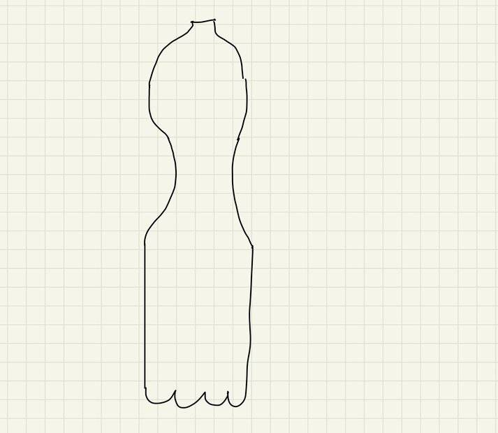

I actually have the bottle, however I do not want to post the concrete bottle or I am going to get a plagiarism strike for posting my own stuff on here. So here is a brief sketch of the contour of the bottle, if this is any help to you.
For the forms of data: I basically took an image and imported it into some software, where I plotted the points along the bottle with decent accuracy. I have to do this again now, which is what I am going to do after this.
By arbitrary locations, do you mean the radii at the different points along the bottle, such as where it is flat, curved, etc?

Ok that's good to know, it's an actual bottle. Are you trying to find the "outer" volume or are you accounting for the wall thickness?
Yes by arbitrary positions I mean can you measure the radius at arbitrary points along the axis. From your description it appears that you can.

I am just finding the volume without counting for wall thickness, which is something I will mention in the evaluation part if there should be small errors.
For the method: This is basically a topic I chose on my own and decided to do it using integration, since the math behind it is appropriate. Although for finding the functions for example, using some methods such as cubic spline should be a nice addition to it I think. The only thing is the maths has to be complicated enough and have enough.

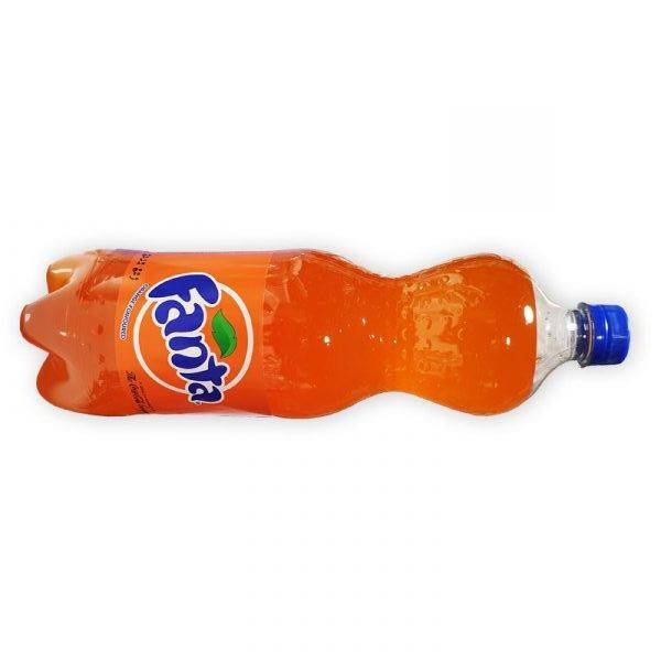

Ok that makes sense to do it that way then. Normally the easiest way to measure the volume with a physical bottle you have in hand is to pour the contents into measuring jug or other suitable container. Or if measuring the outer volume of a complex shape to submerge it and measure the volume displaced.
From your sketch it's something like this PTE Fanta bottle then? Unfortunately there is no radial symmetry near the base of the bottle, so this will probably limit the accuracy you can obtain. Personally I'd just use a cylinder appox for the lower half and about a 7 point Simpson's rule for the upper curved part. It will also be worthwhile considering what approximations you could use to account for the non radial symmetry near the base.
Yes, this is the kind of shape of the bottle. What I thought for the bottom was to model one hole and then kind of subtract that by the number of holes there are...
I don't know if doing approximations would really be appropriate here.
I am not familiar with Simpsons rule, but I will have a look at what it is and how it can be applied to this problem.
Edit: why are you suggesting Simpsons rule for the upper curved part?

BTW, my drawing of the bottle was created by using a spreadsheet program (LibreCalc) to calculate 51 points along the length of the bottle (using the interpolation) and putting the result in "L0 0" form so I could output it as an SVG file. Then I did a screen capture to get the png file that I posted.
Archimedes has provided you a direct way of measuring the outside volume of the bottle:
1) Fill the bottle with water (to make it uncrushable).
2) Partially fill a cylindrical pot with water - enough to submerge the bottle.
3) Submerge the bottle.
4) Measure the water level rise and the inside diameter of the pot.
Likes pbuk
