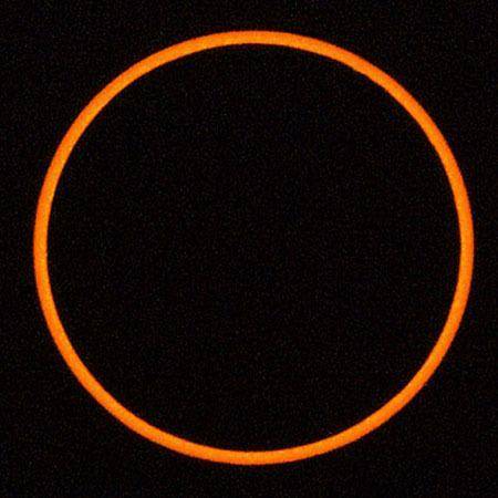

Hope the links I listed are useful to at least some of you, especially beginners. This centerline photo of an annular eclipse was taken using the solar exposure table with no bracketing needed.
