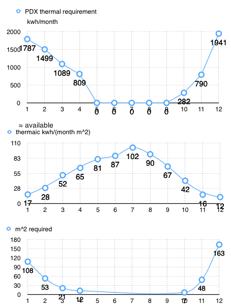

I get 5 °C temperature change per square meter for such a system.
November 5th, at 45.5° latitude, with a 2 axis tracking system.
Total electrical energy collected was 1 kwh.
I would provide the input watts/m^2, but it varies continuously during the day, from zero to 790 watts.
I used the efficiencies of the unit I mentioned in my previous post.
Electrical: 16.7%
Thermal: 30%
Fun problem. I'm glad I never bothered to finish building my solar thermal collector. My sister talked me into buying all the parts when I told her my idea. I told her that I hadn't completed the maths, and that it would be silly to buy everything unless I knew it wouldn't be a waste of time. But she insisted.

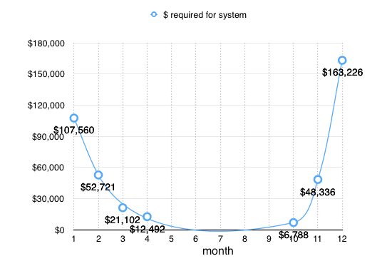

Are you willing to pay $160,000 to accomplish this?
As Rive and I have pointed out, without some type of month+ long thermal storage units, it's a waste of time and money to do any of this.
ps. The graph is for professionally installed units. DIY is probably 10% of that.

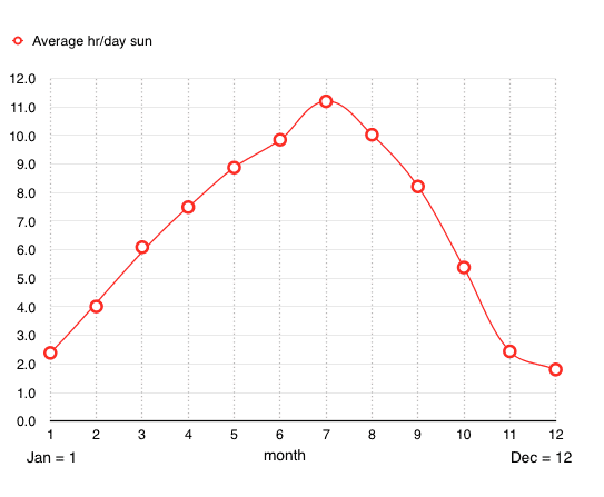

You earlier said
jeff jones said:
i have the acreage and the material but no time
I interpreted "I have no time" as "I don't have time to do this myself", which is why I included in my postscript that you can do this yourself for $16,000, which is very close to your "E Bay has cheap panels and whole systems for less than 15.000" comment.
My WAY OVER optimistic calculation in post #8 was for a 100% sunny day.
A quick check at wikipedia for average (Seattle+Spokane)/2 actual sunny hours/month yielded the following curve:
It's the fact that for the months of November, December, and January, you get less than 3 hours of sunlight per day, on average, is why this idea doesn't quite work in our great northwest.
Unless you're made of money, of course.
On the other hand you can save some on the cost of hot water from March to October and buy more firewood.
That works.

It isn't clear to me what that graph is actually trying to say...
Its origin is based on something said by the OP in post #7;
jeff jones said:
...for minimizing the cost of home heating...
With no mention of long term storage, I simply divided my monthly home heating requirements(graph 1) by the solar energy available per square meter(graph 2) and came up with square meters(graph 3). I then decided on a cost for each square meter: $1000
It's kind of like those new fangled "on demand" water heaters, only this one is solar powered.
And as Rive and I have discovered, it doesn't really (practically) work.
Everything works "in theory", as long as you ignore the cost, and reality.

OmCheeto said:
