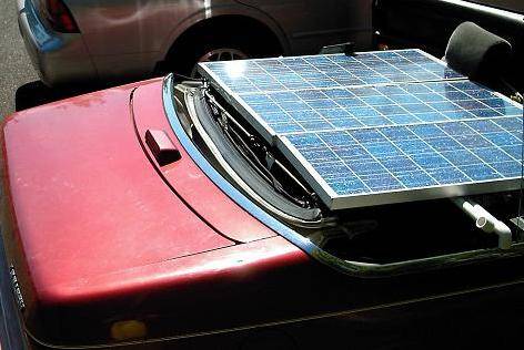

But if you have 750 watts worth of solar panels on your roof, that range of energy can be collected in between 1/2 second to 1/2 minute.
As for your idea in general, I like it a lot. I know a guy who's alternator broke just as he was leaving work one day. Instead of spending $100+ bucks to get towed home, he temporarily installed 150 watts worth of solar panels to his car. Believe it or not, it worked. The trip was about 13 miles, and took about 30 minutes.
Of course, it was a sunny June weekend day when he did this. Had it been a typical November cloudy weekday during rush hour, he would have called a tow truck.
ps. He has since replaced the car. It was the mother of all lemons. It was towed home on two other occasions, and should have been two more times. But the guy is a bit of a nut.
