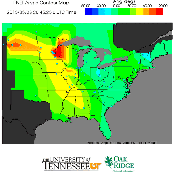

could you set up a network between all cities with a range of a 2-3k miles where if it becomes cloudy and rainy in one city (so solar can only sustain about 20-30% of power needs), other cities within a range of hundreds, or possibly a several thousand mile can jump in? Assuming ofcourse every city in this network has power left over during sunny days.
such a network exists, called "The Power Grid" .
All generators connected to the grid are in synchronism,
regions with surplus power pull ahead by a small fraction of a turn which pushes power into regions with a power shortfall.
Ypu can watch that almost realtime here
http://fnetpublic.utk.edu/anglecontour.html
See the swath of yellow along Mississippi river? It's ahead of most of the rest of the country.
I'd say at that moment Mississippi Valley was exporting power in all directions. Not a surprise, there's lots of coal plants there and in mild weather less efficient plants are shut off. Nukes are refueled in mild weather too, so as to be able to replace their generation with inexpensive fossil.

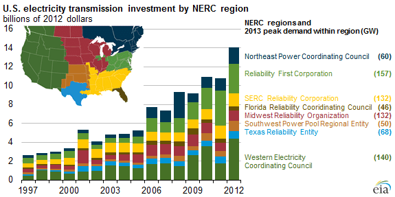

http://www.eia.gov/todayinenergy/detail.cfm?id=17811one driving force is
http://www.ferc.gov/industries/electric/indus-act/trans-invest.asp
The Commission has established rules to bolster investment in the nation's transmission infrastructure, and to promote electric power reliability and lower costs for consumers, by reducing transmission congestion. The rule identifies specific incentives the Commission would allow based on a case-by-case analysis of individual transmission proposals.
The Energy Policy Act of 2005 directed the Commission to develop incentive-based rate treatments for transmission of electric energy in interstate commerce, adding a new section 219 to the Federal Power Act. The rule implemented this new statutory directive through the following incentive-based rate treatments:
  • Incentive rates of return on equity for new investment by public utilities (both traditional utilities and stand-alone transmission companies, or transcos);
  • Full recovery of prudently incurred construction work in progress;
  • Full recovery of prudently incurred pre-operations costs;
  • Full recovery of prudently incurred costs of abandoned facilities;
  • Use of hypothetical capital structures;
  • Accumulated deferred income taxes for transcos;
  • Adjustments to book value for transco sales/purchases;
  • Accelerated depreciation;
  • Deferred cost recovery for utilities with retail rate freezes; and
  • A higher rate of return on equity for utilities that join and/or continue to be members of transmission organizations, such as (but not limited to) regional transmission organizations and independent system operators.
It's attracting European capital.
