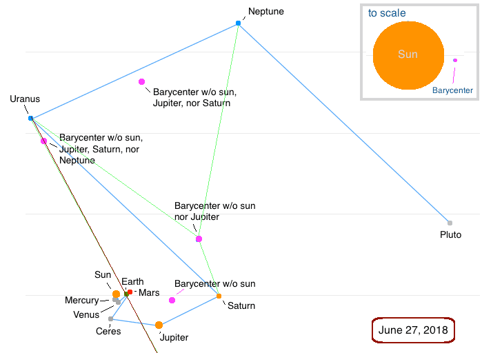

During a harmonic convergence of the major planets does the barycenter ever leave the suns sphere?

Not on average. It is in Jupiter. It does not change much. The CoM of it is not though, Saturn is worth quite a punch too. However, had the OP done the minimal effort first he would not have had to ask the question in the first place. Also, if you actually do the math, Jupiter's mass puts the Jupiter-Sun CoM just about at the solar radius so the positioning of the other planets (mainly Saturn) are important as well.stefan r said:On average most of the non-sun mass of the solar system is in Jupiter.

Yeah: I made a little spreadsheet for a running tally: 107% for Jupiter alone. Another 59% for Saturn. Beyond that only Uranus and Neptune matter and not enough if Jupiter and Saturn are aligned. Earth's impact is much less than 1%.Also, if you actually do the math, Jupiter's mass puts the Jupiter-Sun CoM just about at the solar radius so the positioning of the other planets (mainly Saturn) are important as well.
OmCheeto said:...
9. Equation for center of mass was stolen from Wikipedia.
9.a. I should mention the fact that the first value being zero, confused me; "How on Earth can the sun, comprising 99.87% of the solar systems mass, zero out here?"...
9.b. Did some maths. It seemed to work out.
I saw that. Just didn't like it.stefan r said:The quantity m1r1 is zero because the because r1 is zero.
simply a question of the choice of coordinate system If the reference point is centre of mass of the sun, its distance is by definition zero. All the non zero terms provide the offset of the result from that zero reference.stefan r said:The quantity m1r1 is zero because the because r1 is zero.
