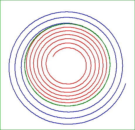

PS: Here is a comparison of the methods:
red: [itex]x_{k + 1} = x_k + v_k \cdot \Delta t + a_k \cdot \Delta t^2[/itex] (your code)
blue: [itex]x_{k + 1} = x_k + v_k \cdot \Delta t + {\textstyle{1 \over 2}}a_k \cdot \Delta t^2[/itex]
green: Leapfrog
Likes BvU

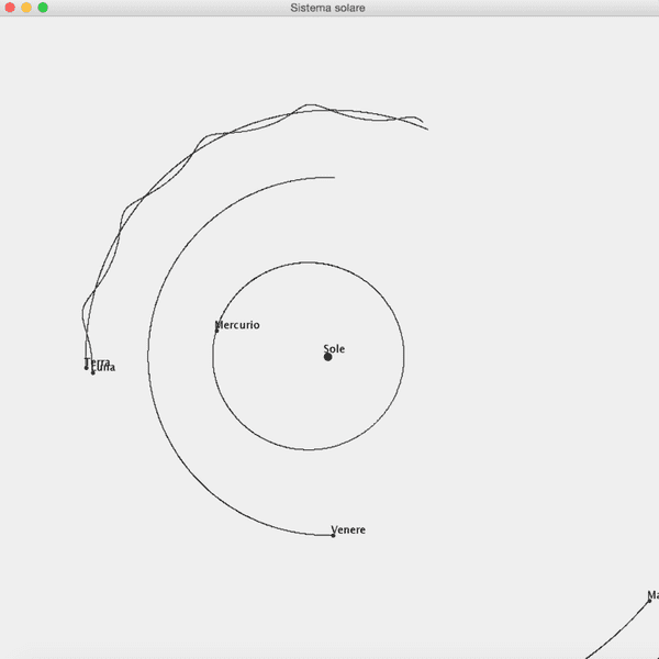

What I can see by my program is:
Thanks
sefiroths said:
However if sonething went wrong I think I had to see a planet falling in the sun or go away from the sun...
Fully agree. So, probably no numerical problems.
And that looks excellent also. Somewhat puzzling that in post #1 you remark
sefiroths said:
but when I add the moon...
which gave the impression you think there's something wrong ?
NIce check: how many moons in a year ?
In the first post I had a problem that the moon had an orbit like the earth, on post #5 i wrote that I had solved the problem, then DrStupid point my attention on a potentially wrong calculation that should lead a falling planet over the sun.
Now I'm searching how to enphatize this error seeing the planet falling down, but after hour of iterations the planet stay on his orbit...
For the check I'll change the program to calculate it
sefiroths said:
How can I make my program go in this spyral way?
Increase the step width to 10000 seconds.
tried and this corrupt even other simulations with other algorithm. in next version I'll implement all methods of calculation to make it comparable
