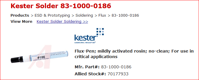

You will get frustrated trying to solder tiny things , especially with 63/37 solder or Heaven Forbid , Lead Free !
The end of your solder has to melt before it starts releasing flux. Applying a little bit of flux first helps a lot.
The last place i worked bought liquid flux in 55 gallon drums for wave solder machines.
I filled a couple of 1 oz bottles with dregs from a discarded empty container and it lasted me several years at home. I found i like it much better than the brown goop from Radio Shack. A nail polish brush works great for applying it.
This looks like a handy product
http://www.alliedelec.com/kester-solder-83-1000-0186/70177933/
mouser, digikey, allied, ,,, all the regulars carry several varieties of it .
