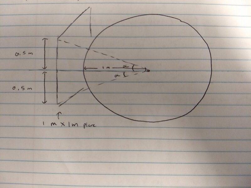

My interpretation is of a square 1 m x 1 m plane sitting behind an imaginary sphere. So the angle ##\alpha = \arctan(0.5)##. The angle swept by phi in the vertical direction should go from ##-\alpha## to ##+\alpha## and the angle swept by theta radially in the xy plane should also be the same given the square shape.
The solid angle of a sphere is ##4\pi##, so the ratio of the solid angles I need is $$ \frac {\Omega} {4\pi} = \frac {1370} {100 N} $$
where N is the number of lightbulbs.
Now for calculating the solid angle ##\Omega## I am getting tripped up.

You are making the problem unnecessarily complicated. At the distance of the bulbs from the surface, the illuminated area of one square metre might as well be a cap of your imaginary sphere, not a flat sheet. In other words, you just want the intensity of power falling on your sphere.
Wrt to your attempt, your first equation is dimensionally wrong. On the left you have the ratio of two solid angles, on the right a power intensity ##(W/m^2)## divided by power (W).
Edit: I may have misinterpreted the question.

I think I am going for the intensity on the sphere ... that's why I did the integral. I only made the plane to try to get the bounds of integration for the solid angle ... I'm assuming the bounds are messed up?
Would it be valid to just ignore the integral and everything and use ## \Omega = \frac {Area} {r^2} ##, so ##\Omega = 1 ## because we have a 1 m^2 area over a radius of 1 m?

I may have misunderstood the question. You are assuming all the light bulbs are concentrated at a single point, which may be right.
If so, no, your original approach was right, but your integral was wrong. The integrand assumes theta and phi represent spherical polar coordinates, but if you project a portion of of a sphere's surface between a range of latitudes and a range of longitudes out onto a plane you will not get a straight-sided figure.
Instead, let's try some geometry. You have a pyramid on a square base. Can you figure out the angles between adjacent triangular faces?

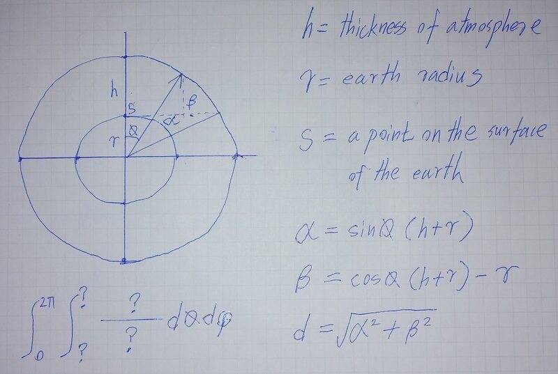

I really don't understand the meaning of this question. The question does not define the actual value of the atmosphere height, and what does it mean to be 1m away from the atmosphere’s edge ?
I believe the following two situations may be easier to understand.
How many bulbs of 100W one meter away from each other (one light bulb per square meter on average) are placed on the edge of the atmosphere will produce the same amount of irradiance (1370 watts/square meter) on the earth’s surface?
How many light bulbs of 100W evenly placed on the edge of the atmosphere will produce the same amount of irradiance (1370 watts/square meter) on the surface of the earth?
