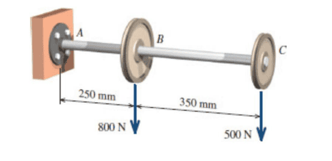

Looking for some help in solving this practice problem, I have tried multiple times and can't seem to get to the correct answers.
The solid 30 mm diameter steel [E = 200 GPa] shaft shown in Figure supports two pulleys. For the loading shown, use discontinuity functions to compute:
(a) the deflection of the shaft at pulley B.
(b) the deflection of the shaft at pulley C.
answers: (1.539mm, 6.15mm)

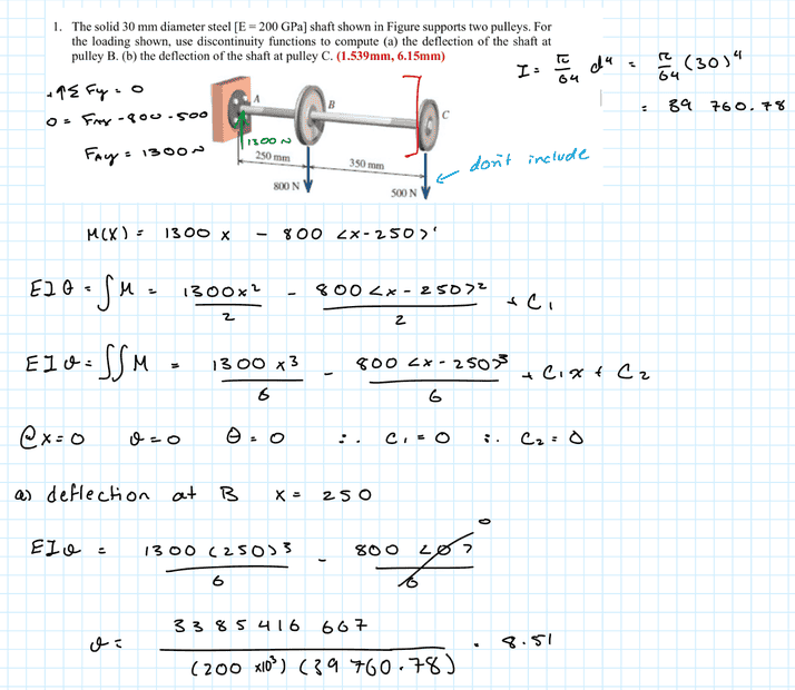

You are supposed to use the singularity function to find the deflections. You need to write the moment as a function of ##x##. Then the deflections come from integrating twice:
$$EI \frac{d^2y}{dx^2} = M(x)$$
Why are you trying to find the shear stress?
Uploaded the wrong solution attempt whoops!
heres the correct one.
There should be a constant moment that you have not included in ##M(x)##. There may be more, but start there( i.e there is vertical reaction and moment at A under equilibrium).
