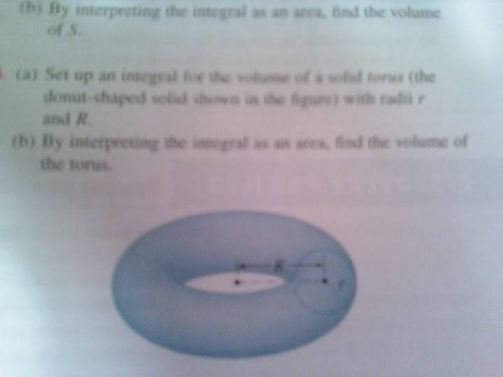

The problem reads(from Stewart Calculus Concepts and Contexts 4th edition, Ch.6 section 2 pg. 447 #45
a)Set up an integral for the volume of a solid torus(the donut-shaped solid shown in the figure) with radii r and R
b)By interpreting the integral as an area, find the volume of the torus
[tex]\int\\pi(1-(R+r))^2-\pi(1-(R-r)^2))dx[/tex]
according to the back of the book this isn't correct. I basically treated this like a washer and did the area of the outer-inner functions and integrated. Heres a picture from the book that may help..

Your integral doesn't have dx or dy, or any indication of what the variable of integration is. Also, why does 1 appear in your integrand?
One approach is to use cylindrical shells of thickness [itex]\Delta x[/itex]. You will need to find the equation of the circle. Its center is at (R, 0) and its radius is r. Find an expression for the incremental area [itex]\Delta A[/itex]. I'm sure your text has an explanation of the shell method and several examples.

I suggested using cylindrical shells. Stewart seems to be using disks of thickness [itex]\Delta x[/itex]

Okay so I got an annoyingly close answer according to the back of the book.
My answer is 4[tex]\PiR[/tex][tex]\int\sqrt{r^2-y^2}dy[/tex]
^^ I don't know why 4PiR isn't showing up before the integral. Latex is still new to me and I have no idea why my posts writing is being split so far apart either.
The answer is has an 8 instead of a 4 though. Would this have anything to do with the limits of integration being from 0->R instead of maybe -R->R?

You are using "washers" of thickness [itex]\Delta y[/itex]. What is the range of y values from which [itex]\Delta y[/itex] is a subinterval? It is not 0 to R and it is not -R to +R.
