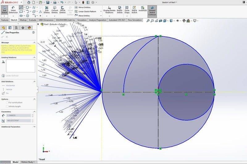

When I try to sketch geometry in solid works, it creates a lot of extra lines that do not go away until I snap back to the starting point of the line.
Hi Everyone,
I could use some help in SolidWorks, when I go to sketch geometry, the software creates a lot of lines that extend off the starting point and they don't go away until I snap back to the starting point. I have an image attached to show what is happening.
This creates a problem since the screen gets very messy and it becomes difficult to see things. Has anyone run into the problem before or have any ideas on how to fix it? I checked through the settings and couldn't find anything that would really cause it. Any help or advice would be great, thanks!

Another possibility is those may be Dimension lines of some sort.
Try turning Off all the Tools in the program then turn On only those Tools you must have for the sketch you are doing.

I don't know solidworks either but I dabble in Blender. Those numbers are all lengths of the line segments extending from the origin. Is it possible you have a ruler or dimensioning tool turned on while you are orienting your space and it is treating every mouseclick as a measurement?
I see a feature in the menu called Smart Dimension.

Hi Guys, thanks for the response! I did some digging online and after a long search I found out that it was a problem with one of the graphics settings. Deep in the settings of the software there is an "enhanced graphics" setting that apparently causes that issue sometimes. After turning it off it solved the problem.
Thanks for the suggestions!
