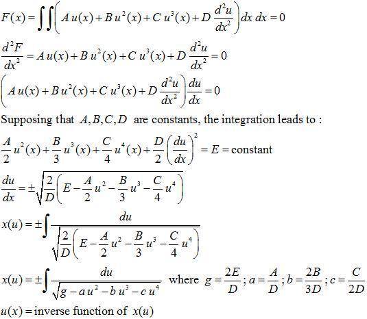

Here is an equation that I have tried for few days to solve and still haven't succeeded, I'm interested to solve this 4th order wave equation to find u(x).
∫∫(A u(x) + B u(x)2 + C u(x)3 +D u''(x)) dx dx=0
the 4th term is second derivative of displacement u(x). I assume constants are zero.
I would appreciate any hint or comment.

Hi !
This non-linear ODE is analytically solvable, leading to the inverse function of u(x).
The result on the form of x as a function of u is an elliptic integral (attachment).
Solving this elliptic integral involves the roots of a polynomial equation of the 4th degree. As a consequence, the formal result involving an elliptic function is a very complicated formula :
http://www.wolframalpha.com/input/?i=integrate+du/sqrt(g-a*u^2-b*u^3-c*u^4)&x=0&y=0
The function obtained x(u) is so big that computing the inverse function u(x) in terms of Jacobi elliptic functions is probably not realisic, nor usefull in practice. Numerical methods for solving the ODE are more convenient.

These types of equations are called "Autonomous" and they are very common in classical mechanics (Hamiltonian systems)
in this case $$\frac{d^2u}{dx^2}=f(u)$$ is second order special case! (it is independent of first order derivative). terms in $$f(u)$$ come from some nonlinearities in the system. the original equation derived from Hamilton principle is order 4th, we can reduce the order to second by integration, after that we should solve the ODE with some uncommon functions and approximations like Jacobi elliptic cosine function! it is not as easy as separation of variables! A, B, C, and D are constants and they are related somehow with speed of wave.
